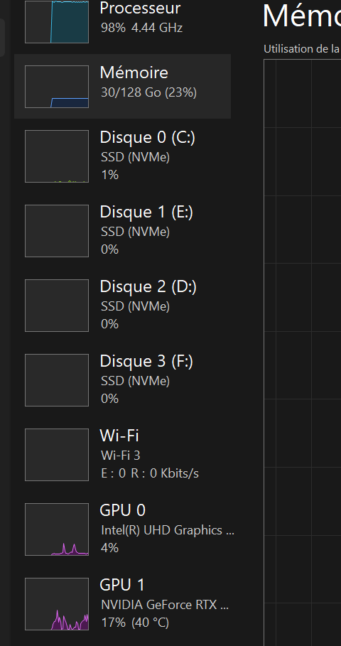

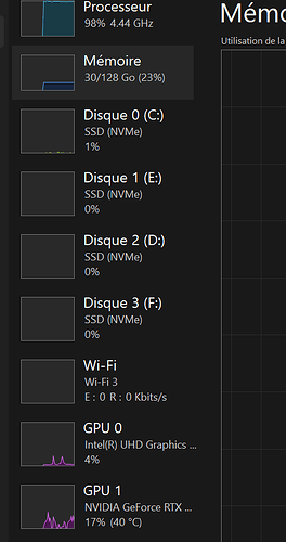

I had a previous attempt hit 10 minutes and still be at 0%
I have a 9950x3d and 128gb ram

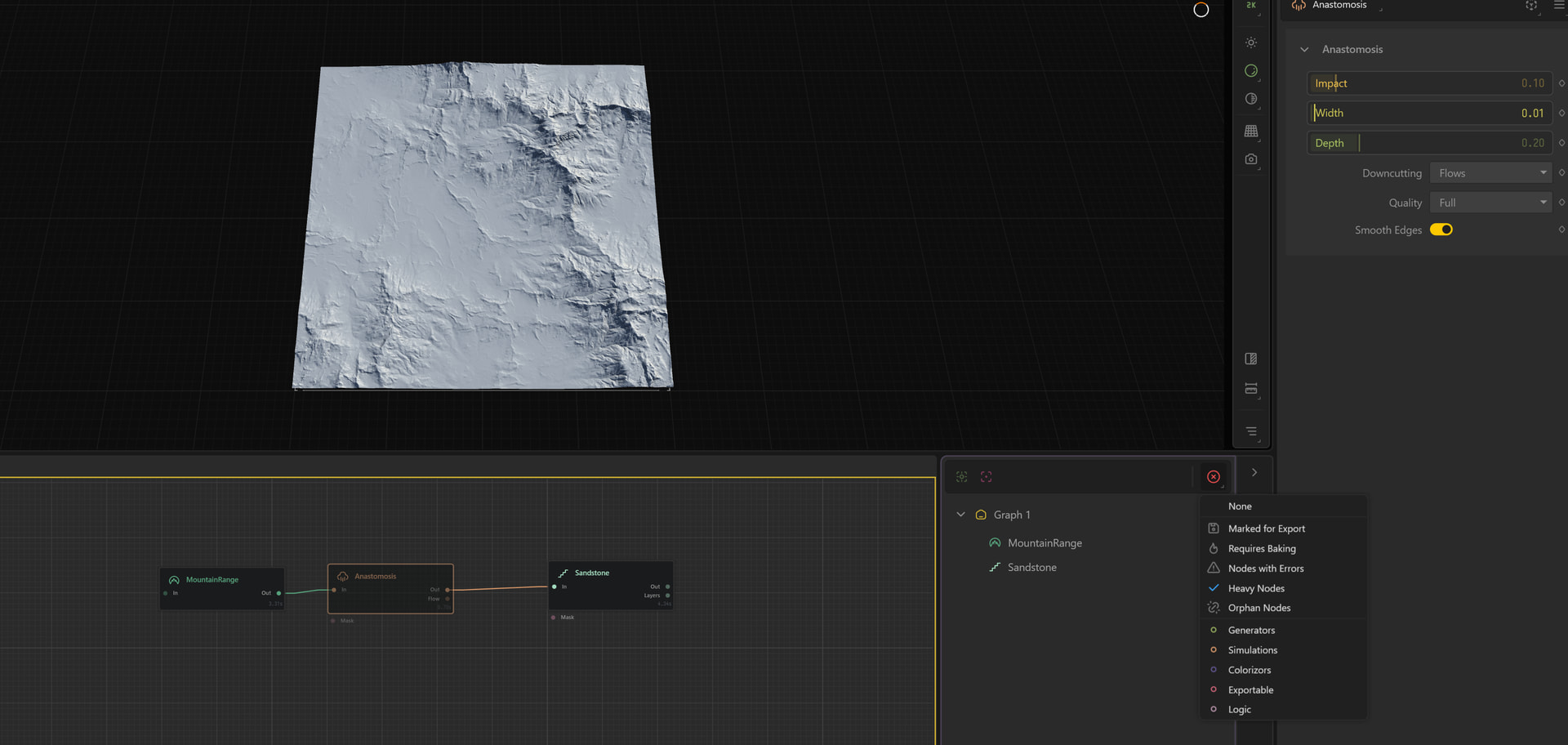

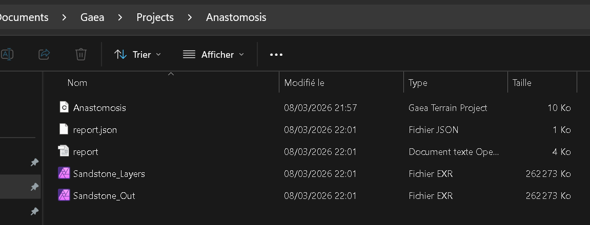

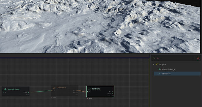

I just exported a 8K 3 nodes test terrain : mountain range / Anastomosis / Sandstone
Although it’s not listed as an heavy node, anastomosis is the one, from far, who took the most time to build using 100% of cpu (i9 13900 K). but it built and exported.
Maybe you didn’t wait long enough.

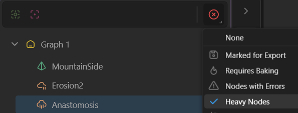

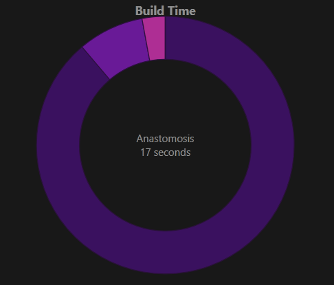

Just an FYI it should be listed as a heavy ( this is relative to the graph), by default the quality is as low as it can get, but the modes and values can change accordingly

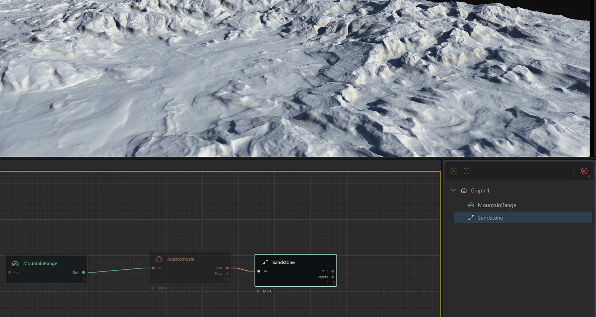

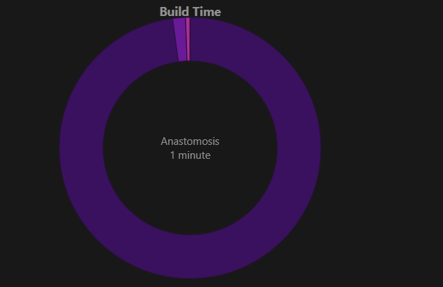

Here is the difference between quality modes min and max and downcutting on the same graph
If you’re using it early for shaping, bake it, use the statistics tab to help gauge your nodes as well as graph tooltips.
not all nodes modes have the same performance, so think carefuly about their values, modes and impact

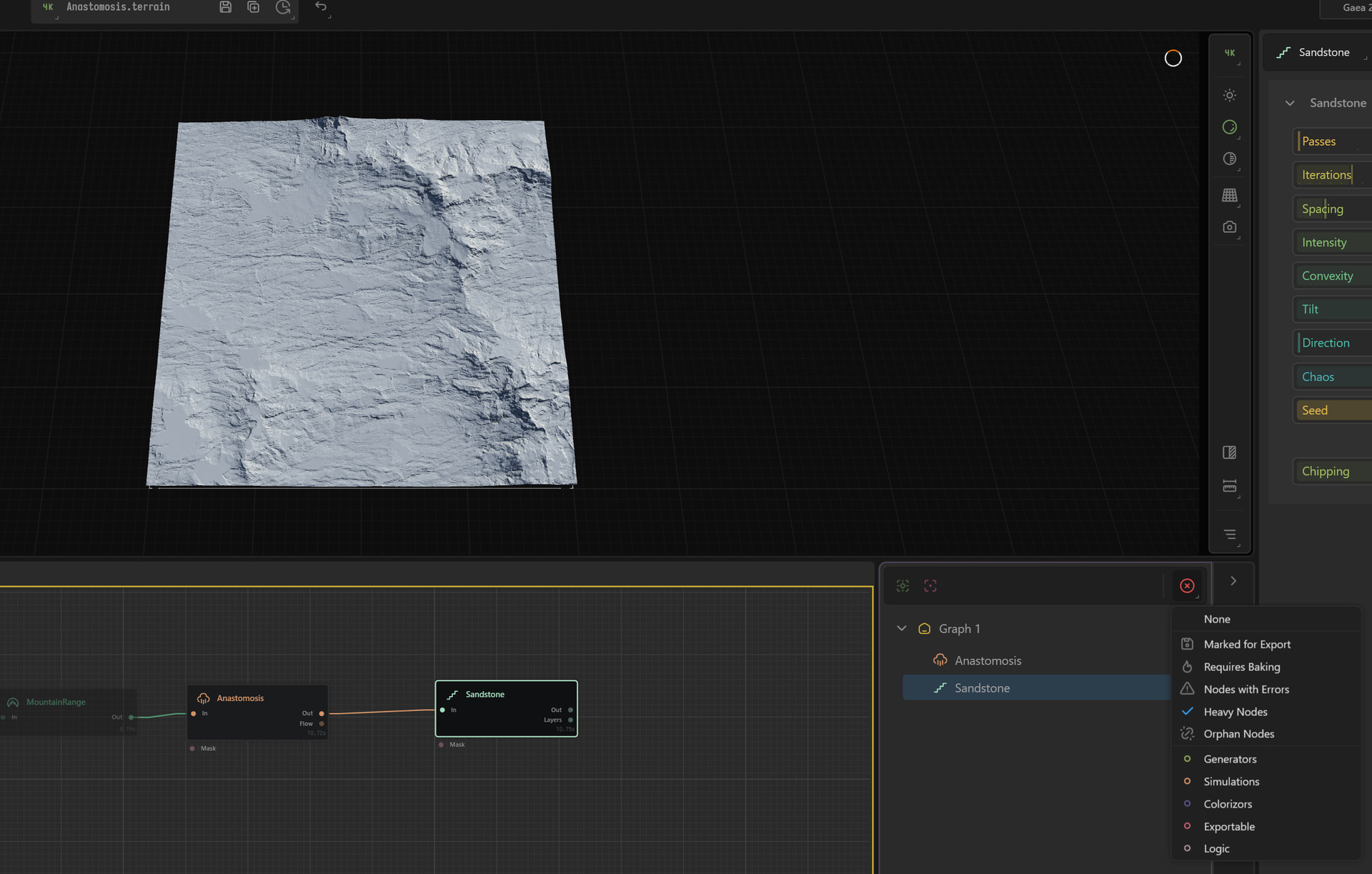

Erf… Look at this:
Anastomosis full quality, listed as heavy node on your screenshot and not on mine :zany_face:
