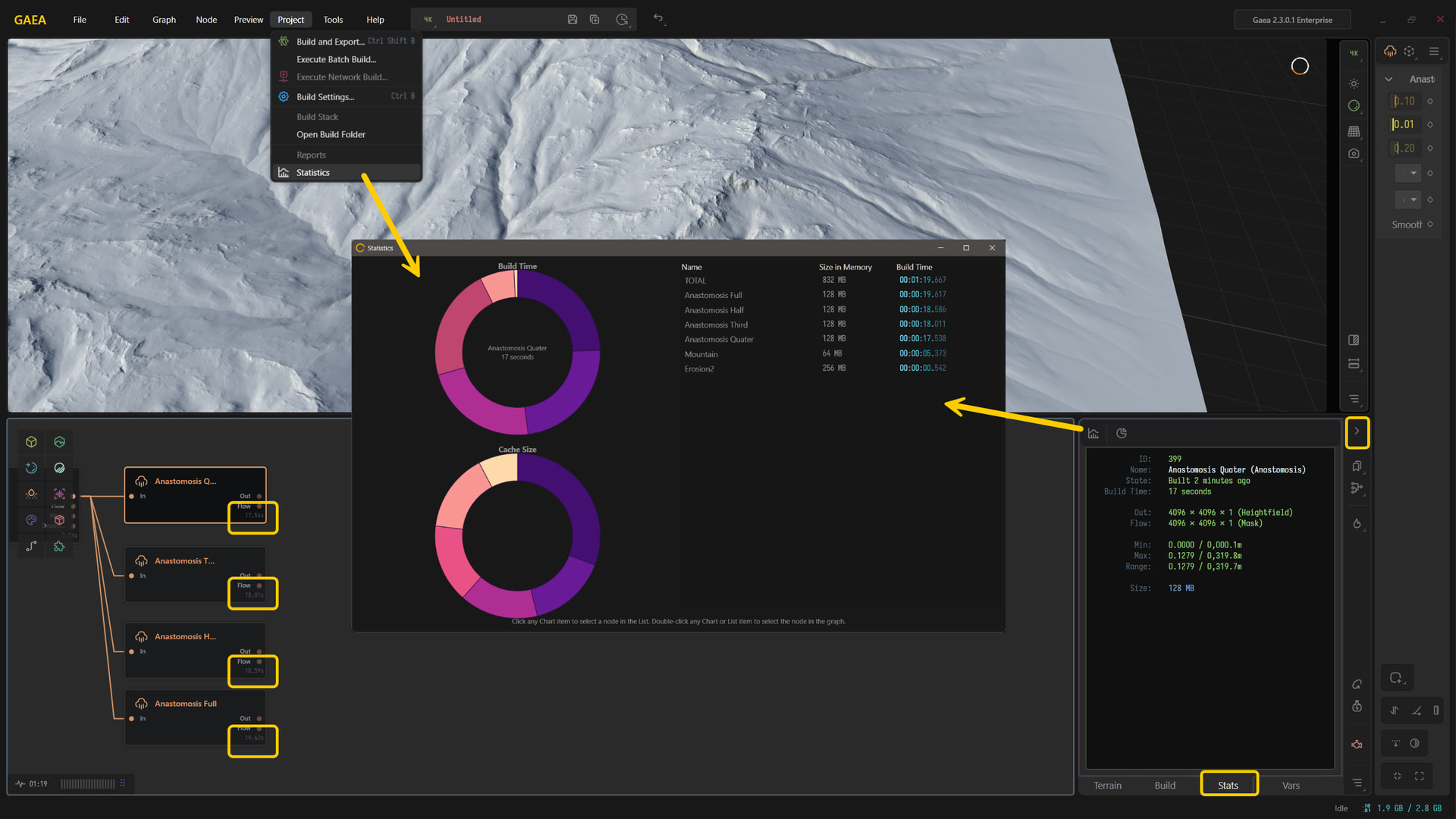

  • sometimes it’s also worth check stats in data view to ensure a node hasn’t just failed.

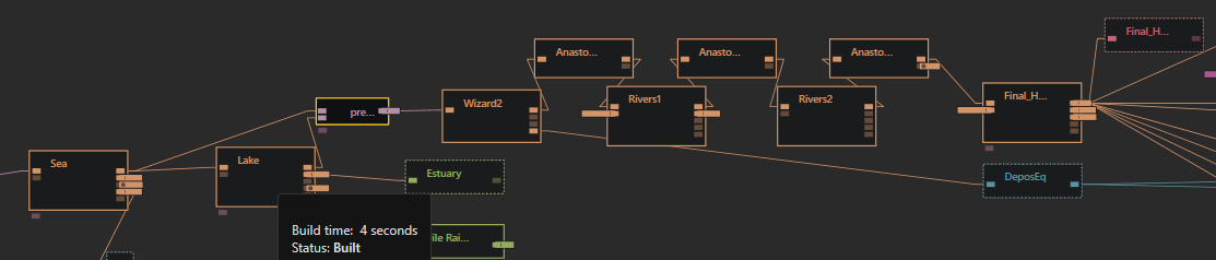

So no nodes actually failed according to the build stats, but I think this maybe the first time I have used Anastomosis, so not sure if processing time is usually so long, but nothing else is taking anything like the time that node is taking, so thinking that is likely to be the point of contention. Any thoughts? Here is a clip from the stats:
                                         Anastomosis │ 0:04:59.556
                                             Rivers1 │ 0:00:49.368
                                         Anastomosis │ 0:05:06.631
                                             Rivers2 │ 0:00:56.359
                                         Anastomosis │ 0:04:50.18
If it puts things into context, here is how it is used at the present:

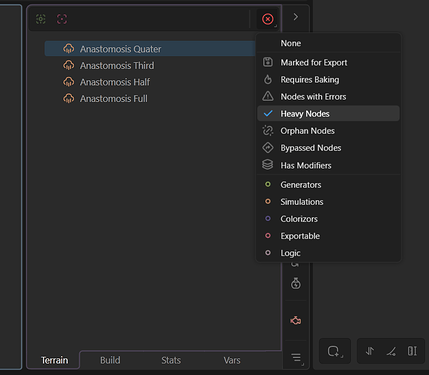

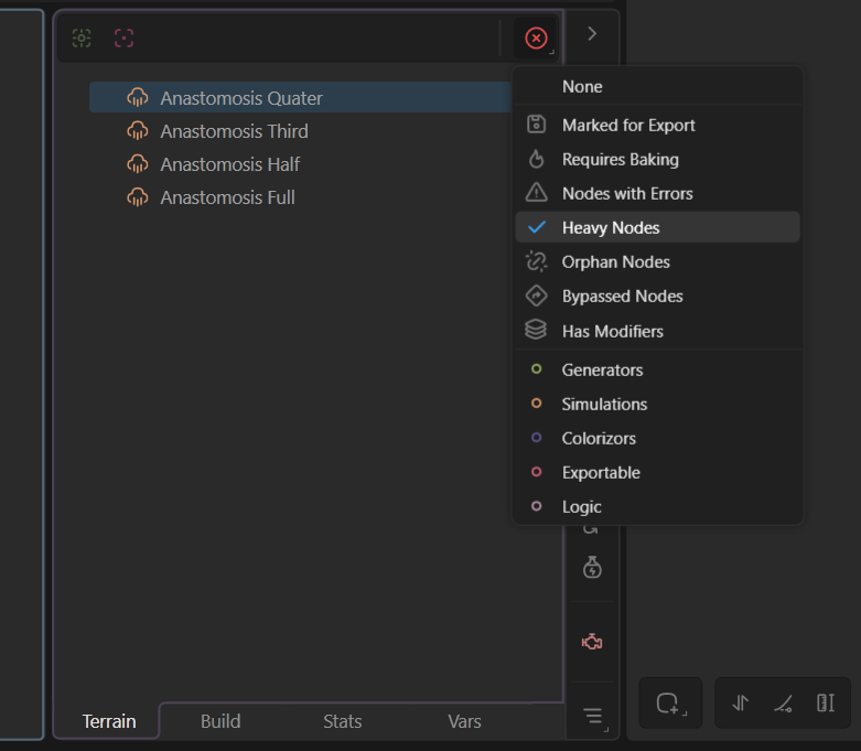

/anastomsis is a heavy node
It’s something you’d want to use sparingly, namely at the end of a chain of processing, rather than multiple times ( if you can help it).
There are quality settings in this node; you can see that each quality is slightly higher to process from the erosion 2 node, but it’s astronomically more expensive at higher resolutions, compared to the erosion 2 node, which scales well.
