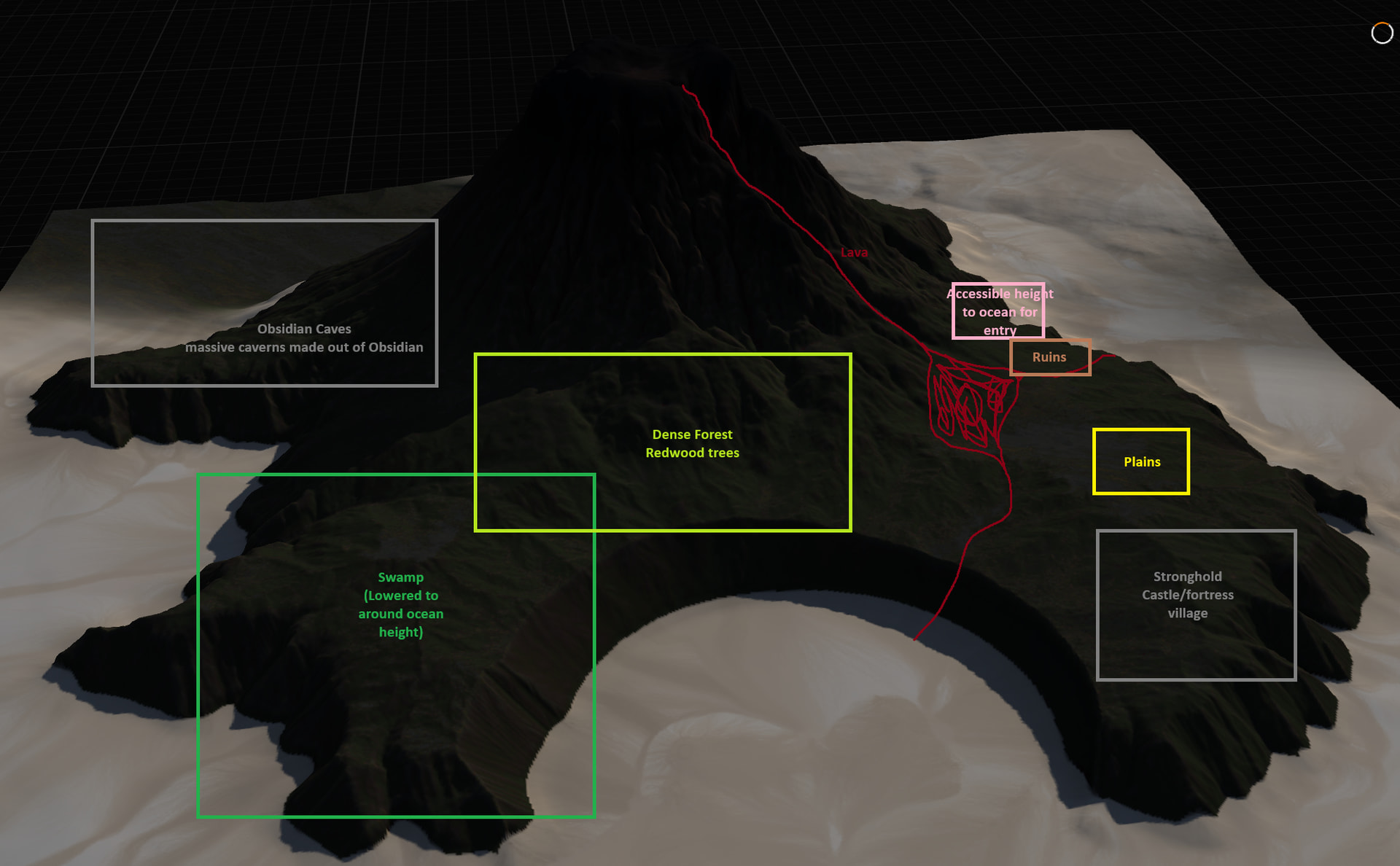

I appreciate you replying! A screenshot of my legendary map planning on Gaea node ideas is below:

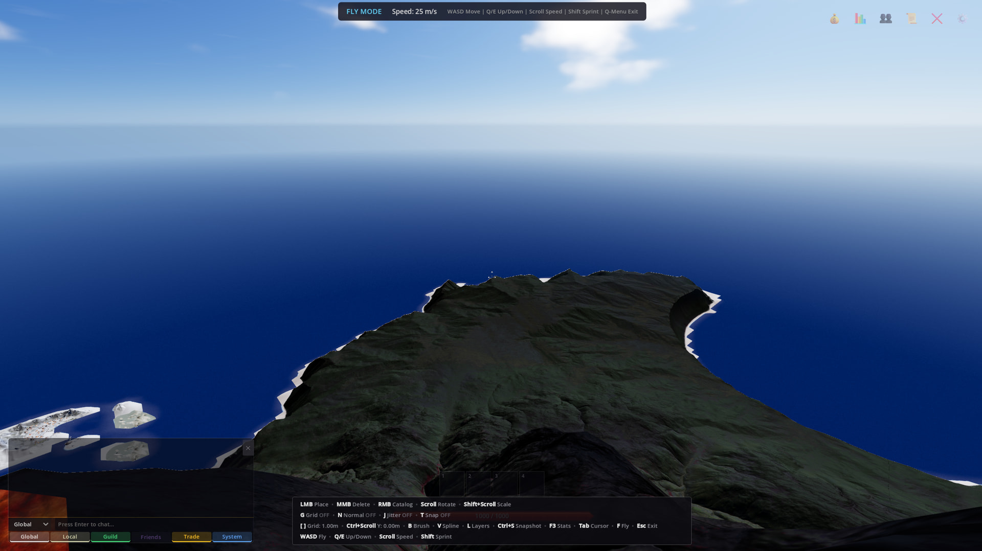

And in game it looked like this from the top of the volcano (in build mode):

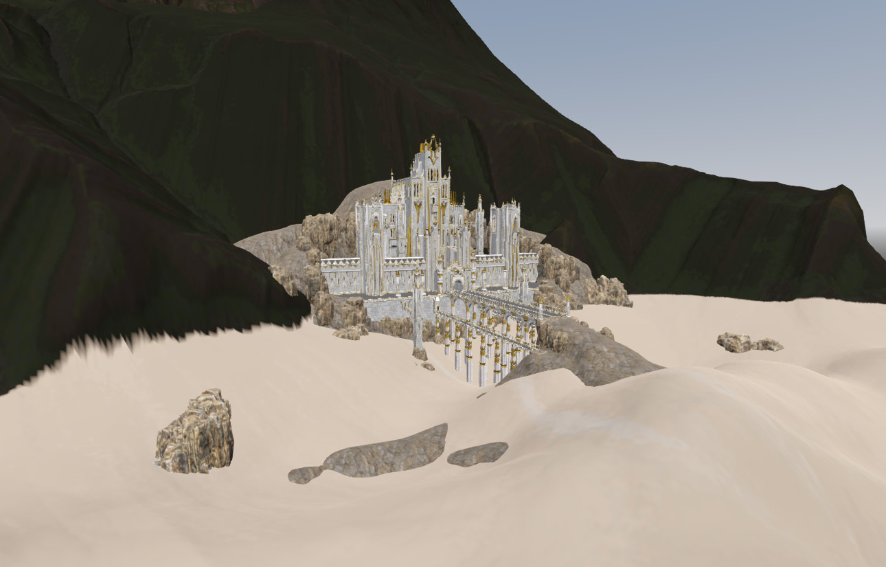

Ocean height is actually around 460m here, which allows for a lot of underwater gameplay (endgame harpoon fishing) and some cool underwater content later without needing negative y. The “little” island to the side is blocky just due to HLOD, but if performance is good enough then I’ll scrap the lowest HLOD tiers entirely. My engine is a fork of Godot which is very extensively changed. I built what is equivalent to world streaming in UE and I’m very happy with the performance/results. I’m able to support multiple 64km x 64km worlds with 144 fps and 8km sight lines! I’m sure that is going to dive off a cliff as I finish adding in the mesh environments (example below on the volcano island) but the baseline for excellent foundational terrain is great.
