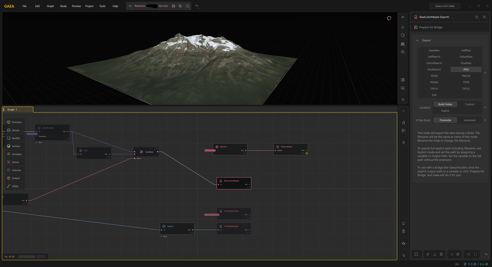

Hello, I am trying to export my terrain for use in blender like I always have, using the Export node for the base color texture.

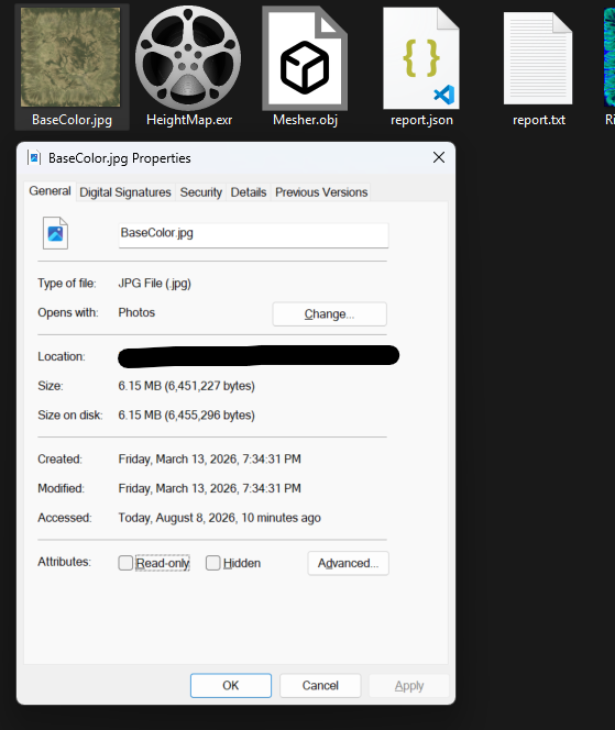

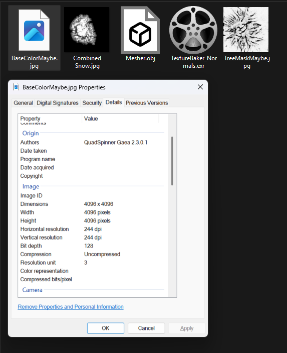

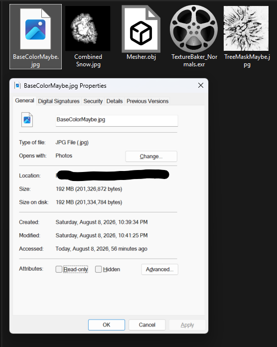

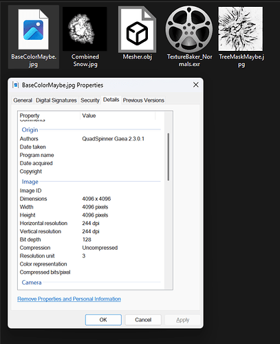

My current project exports a 4k JPG image that is a ridiculous 192MB for some reason. Windows also says it’s 128 bit depth.

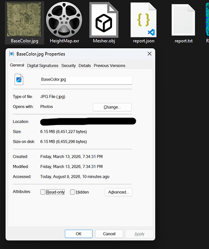

This makes no sense since the export node says JPGs are exported as 8bit. My previous projects would export 4k textures at file sizes of around 6 MB, which seems about average for a JPG of this resolution. Windows apparently still says this is 24bit, so I don’t know what’s up with that.

Current Project
Old Project

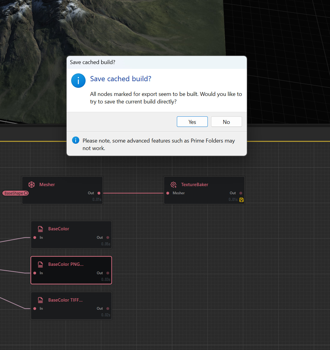

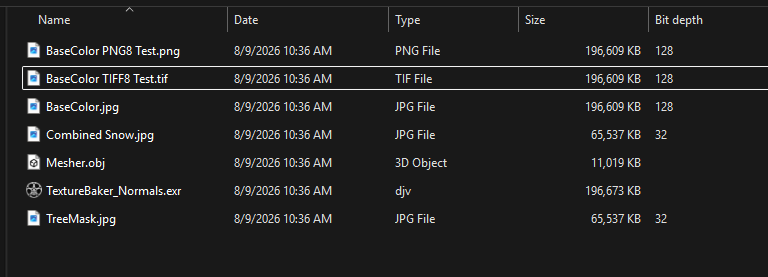

I submitted a bug report. Afterwards I did some more testing and found something relevant. When executing my build, I get the option to save the cached build directly since I have Gaea set to 4k and am exporting at 4k.
If i select “Yes,” this consistently produces the extremely large file sizes with 128 bit depth. Note that I have 3 export nodes for troubleshooting, JPG, PNG, and TIFF, all set to 8-bit.

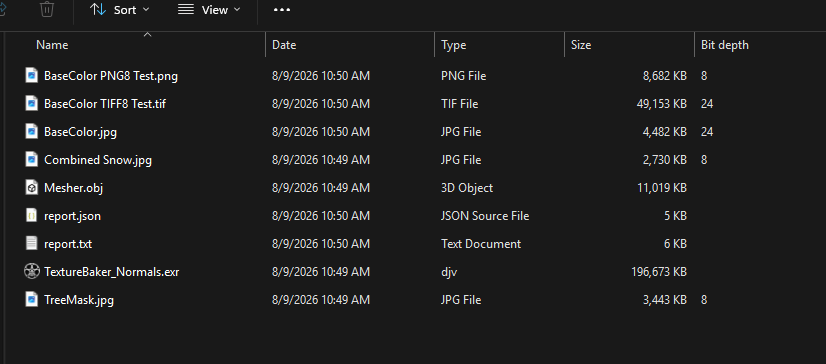

However, if I select “No,” all of the file sizes are a smaller, more expected size:

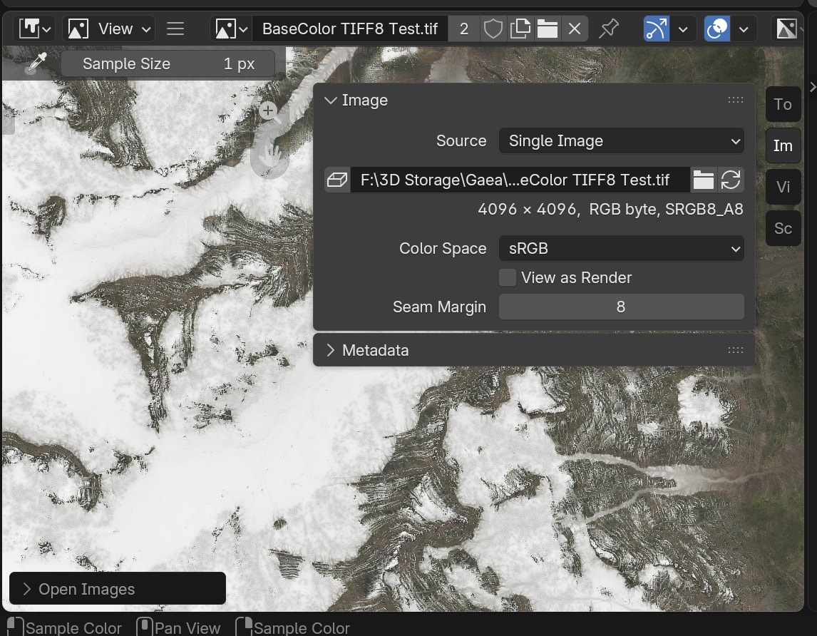

The PNG8 export is correctly reporting a bit dept of 8 bit. I am still not sure why the TIFF and JPG exports are saying they’re 24 bit. If I open these files up in blender, all 3 are reported as 8 bit.

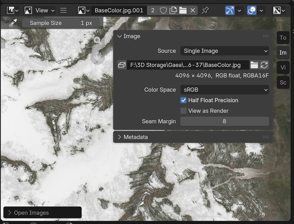

Oh and for curiosity’s sake, this is what blender reports for the cached build direct saves: 16-bit instead of 8-bit.
Some software/OS sometimes read the total bit depth. 24bits is most of the time three 8bit channels, RGB.
You can have four 8bit as RGBA labeled as 32bits.
For your huge files, they are probably just RGBA 32bit for a total 128bits, straight from the 32bit float data in the cache.
