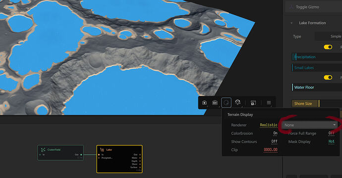

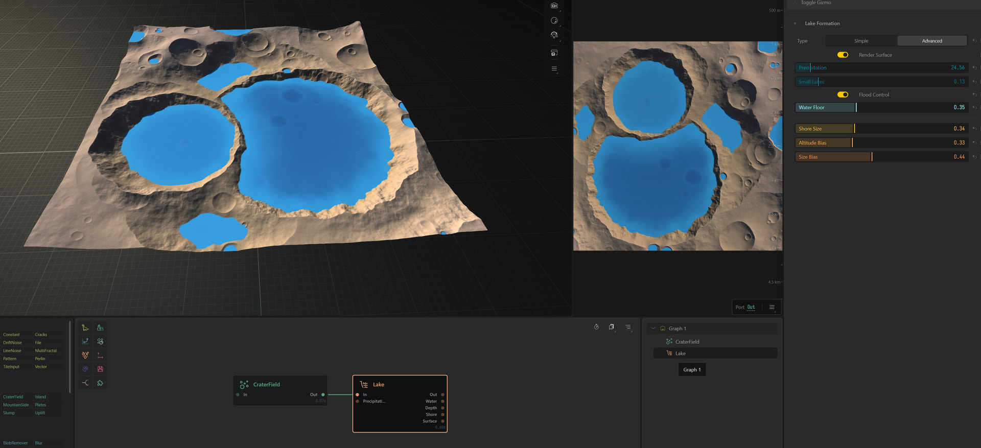

Lakes => Advanced (Flood control on or off):

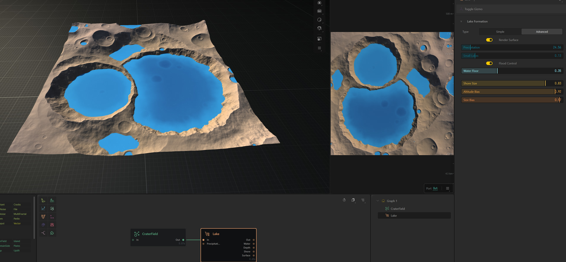

Shore Size, Altitude bias and Size bias have no effect.
All those sliders work for me at all resolutions.
Try with a blank file and simple setup of a few nodes. If it doesn’t function for you still, I suggest making a report inside the app so that your log is attached, it will most likely be quite helpful to detect where the issue is.
Report done.

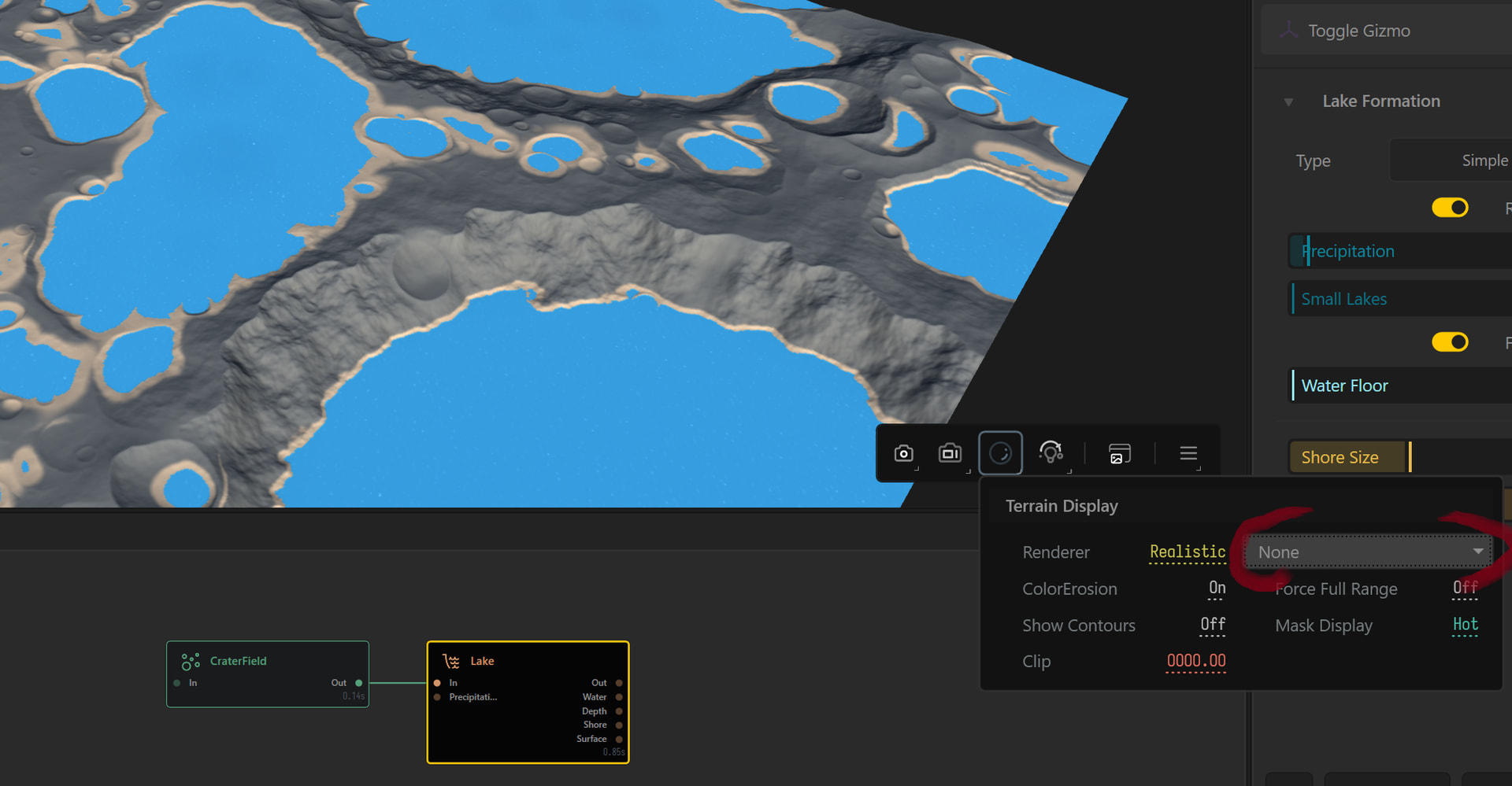

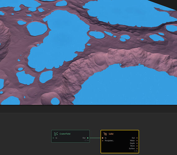

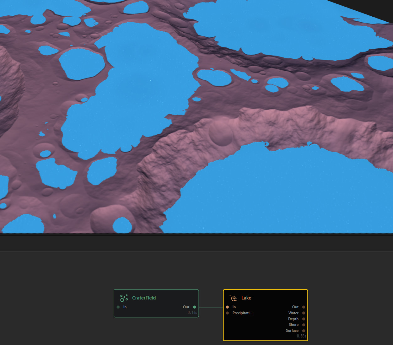

Figured the issue. The shore display doesn’t work when Terrain Display is on.
For now, I suggest turning it off if it gives you trouble for sea/lake shore masks or other masks.
Yes. Terrain display to none it behaves as usual.
