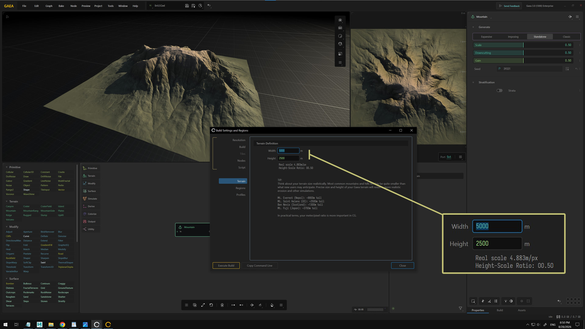

Here I added a mountain node.
Note the sun and the shadow created by the sun in viewport at the default 5000m X 2500m:

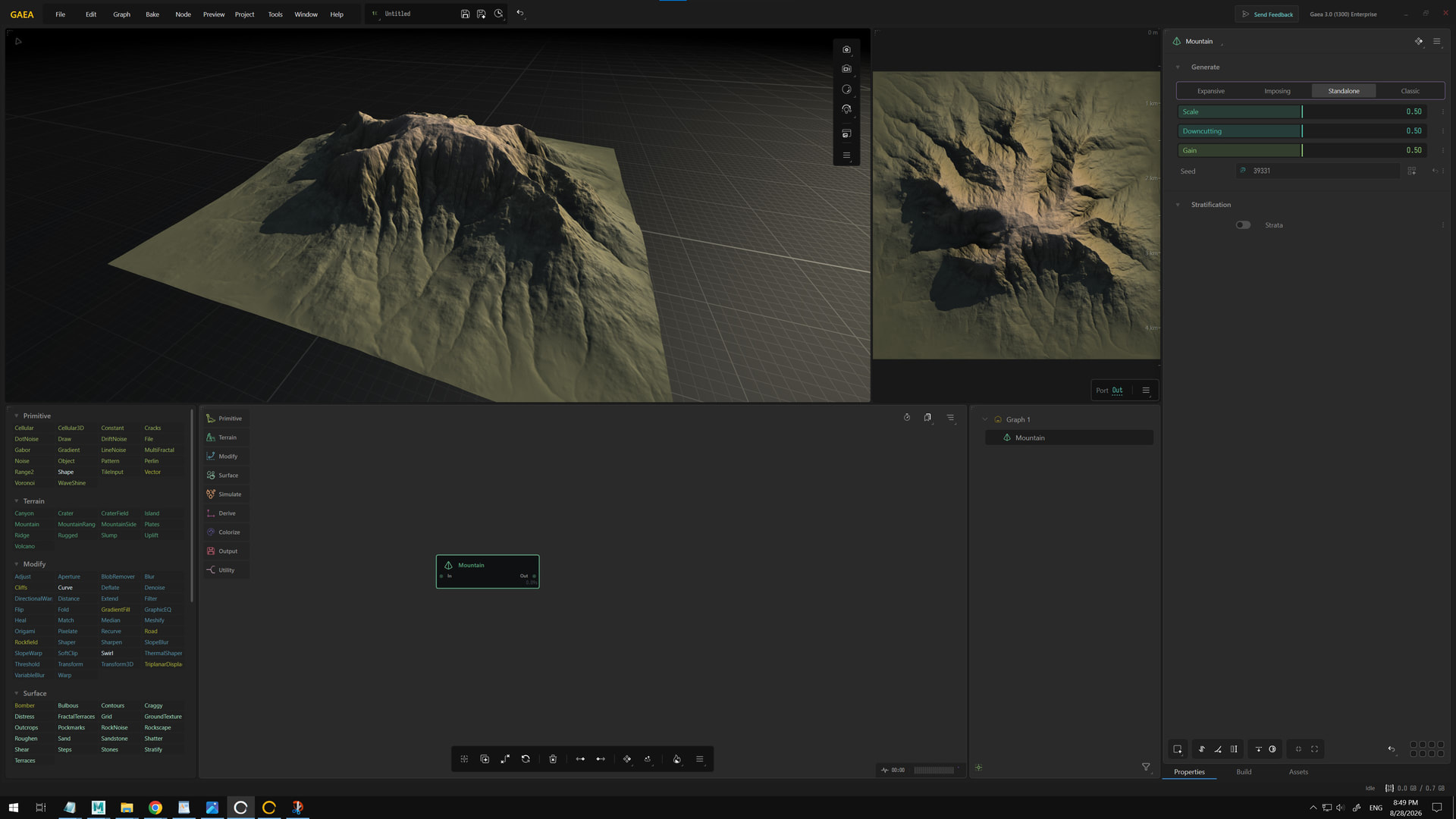

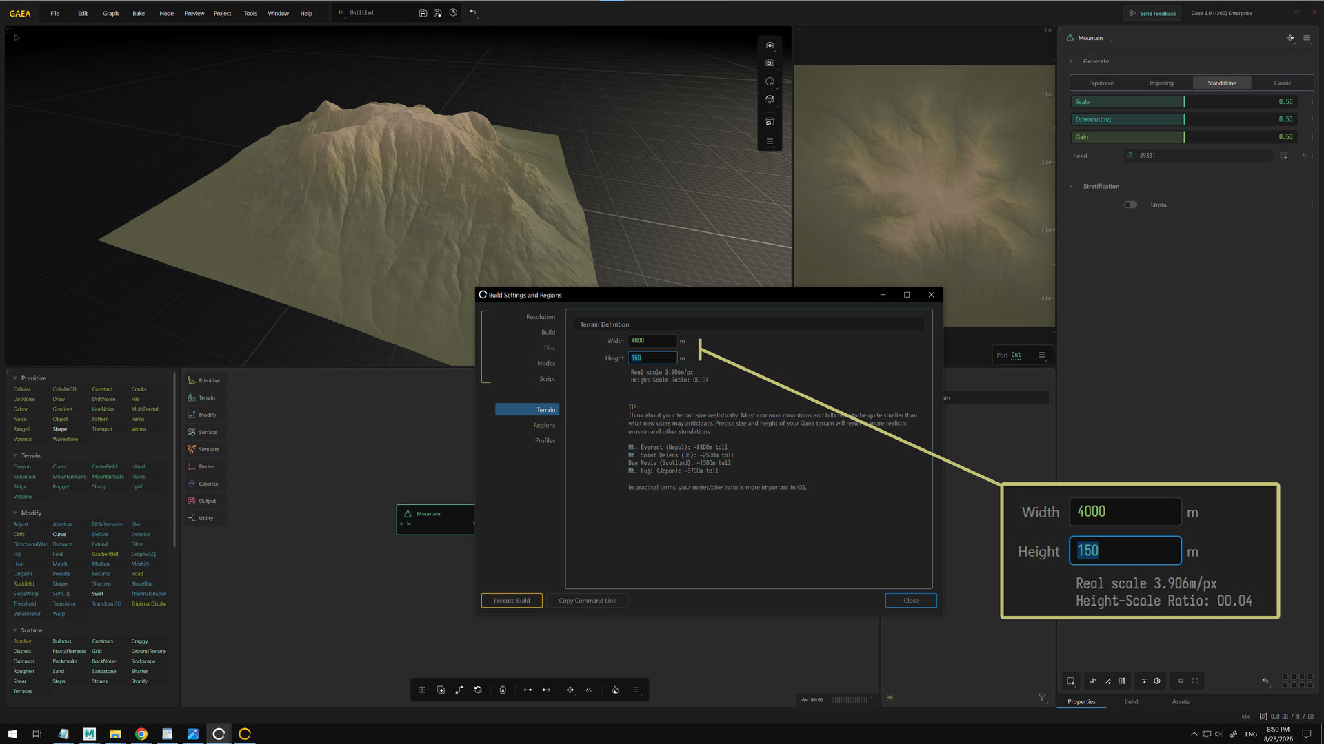

I was looking to create an island that is approximately 4000m in width, and 150m in height. The sunlight and the shadows fully disappear in viewport when set to these values:
Initially I wondered if I set the height to a size it shouldn’t be allowed to. But if I

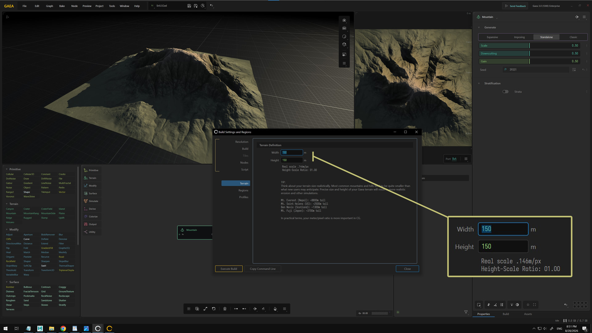

make the width 150m to match the height, the light and shadow turn back on.
The light and shadow appeared to be tied to the difference of values between the terrain width and height.

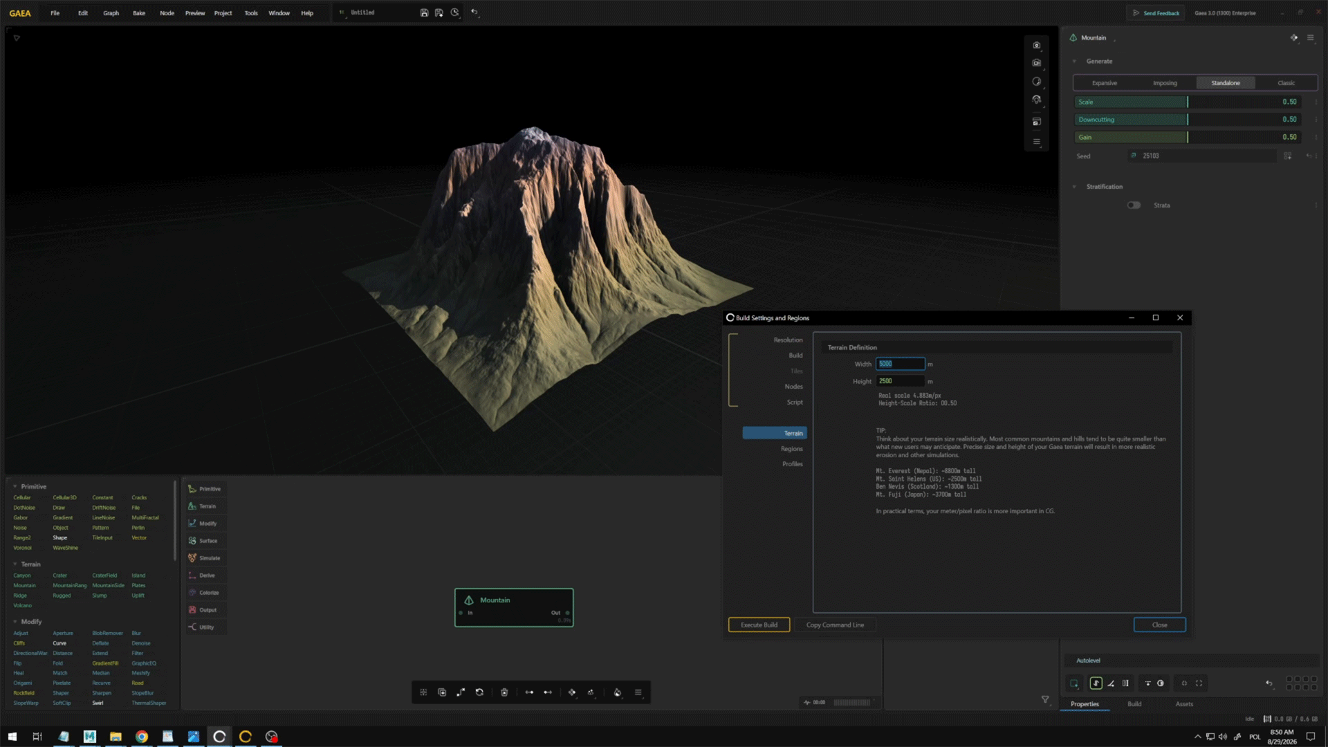

In Gaea 2 if I keep the default terrain width and change the height to 150m.
Now the mountain is super flat, thus less shadow:

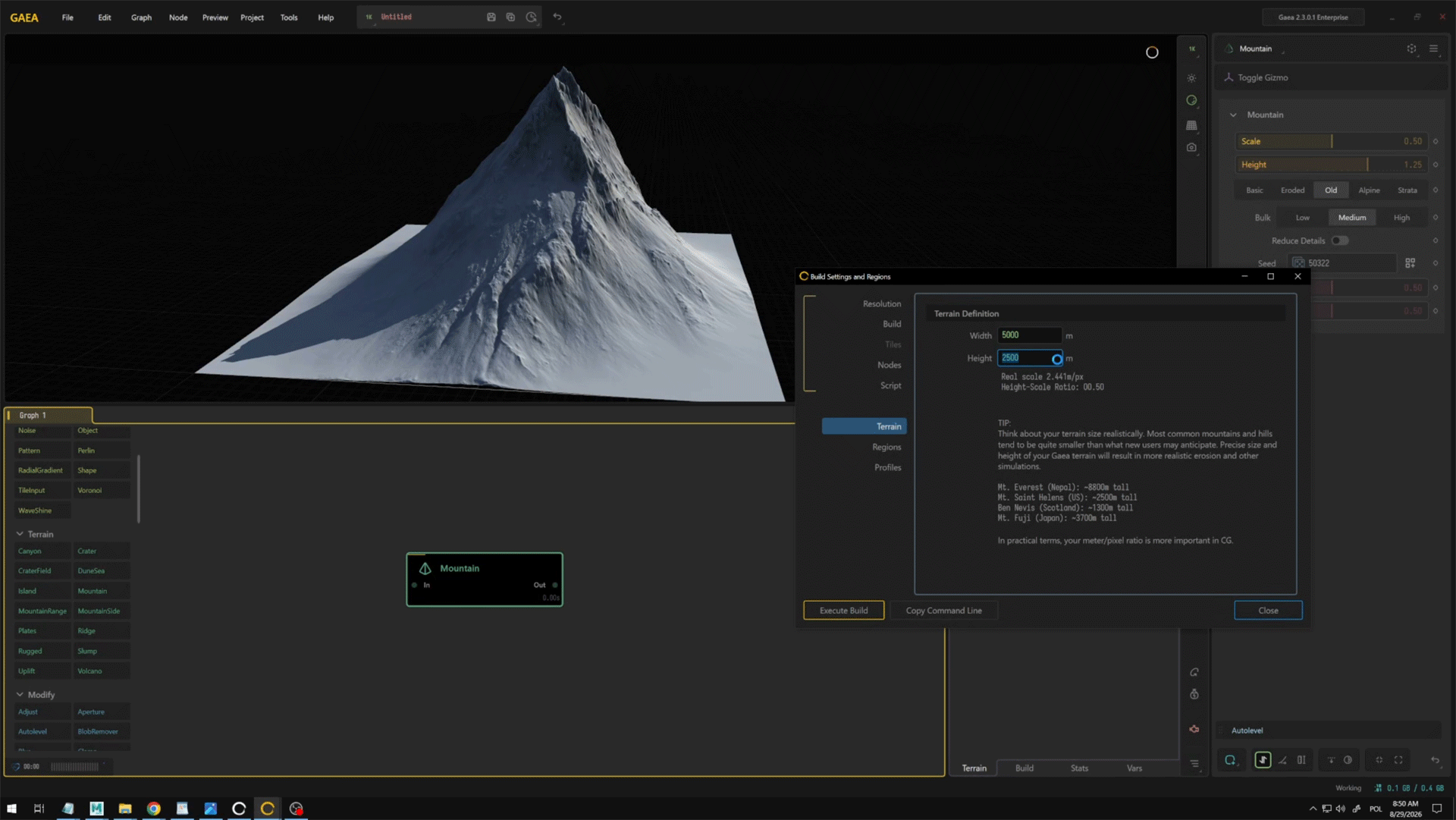

In Gaea 3 EAP, changing the dimensions in build settings doesn’t update the mountain dimensions. Keeping width at its default 5000m, and only changing the height to 150m, the terrain doesn’t change but the lighting does.
The mountain retains its dimensions it had at Gaea’s default 2500m height and 5000m width:
Gaea3_EAP_TerrainHeight
