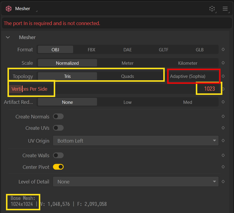

Where do I connect the mesher? When I connect it to the final mesh chokepoint it says “invalid edition”
After the Heightfield that you wish to export.
This is likely one of the points I mentioned before: for the community edition, you can’t use a resolution higher than 1024 or adaptive topology mode.
I’d check the following settings:
  • ensure that the vertex per side is 1023; this is because mesher resolution is n+1, meaning if you set the vertex count to 1024 it’ll try to build 1025, which is beyond what is allowed for the community edition.
    You can check this by looking at basemesh at the bottom of the window.
  • Also ensure that Adaptive (Sophia) isn’t selected, as this also isn’t supported in the community edition.
  • Finally, in your Build Options ensure that resolution is set to 1024.
Looking into it now, thank you. I will get a license as soon as possible.
I appreciate all your help!
Awesome, I have it exported and done. Will post some visuals and an animation as well. Thank you again!
