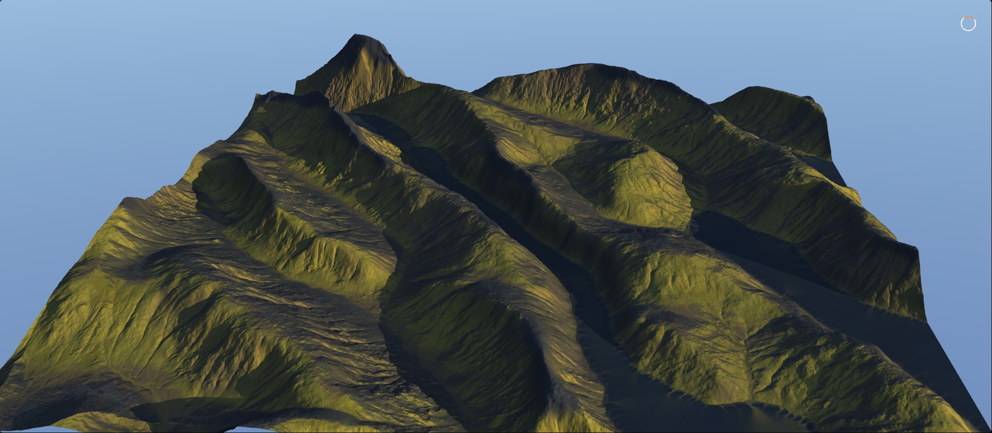

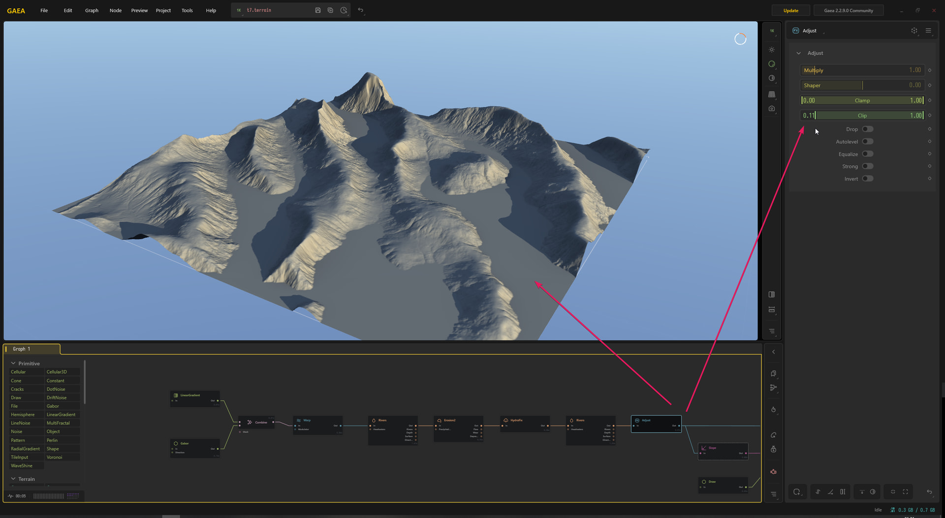

I watched YouTube videos made by guys from Quadspinner, and they were quite easy to follow. Now, making something from scratch is not that easy, though. I found some pictures from Iceland, which I assume is an old glacier. I did make something that resembles a general shape, but I got stuck. Particularly, I am having trouble with the valleys where water flows. In my example, I approached this scene by applying Gabor → Warp → Erosion2, and then Clipping at the bottom. At first, this clip gives a very nice transition (at least it looks like to me) between the mountain and the valley. However, as I start adding more details, like rivers or other forms of erosion, this flat area gets details I do not want, like sediments. Additionally, variations in Gabor do not always reach the minimum value, which creates additional obstacles when I try to make the valleys. I can compensate for the unwanted details by applying Clip one more time, but then it gets very repetitive, which seems wrong.

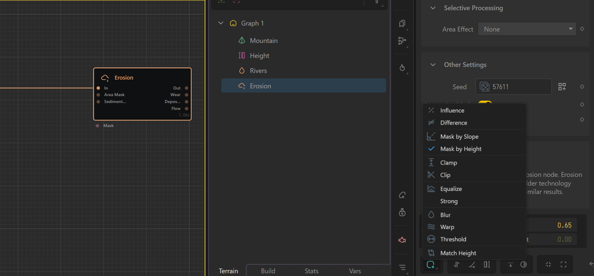

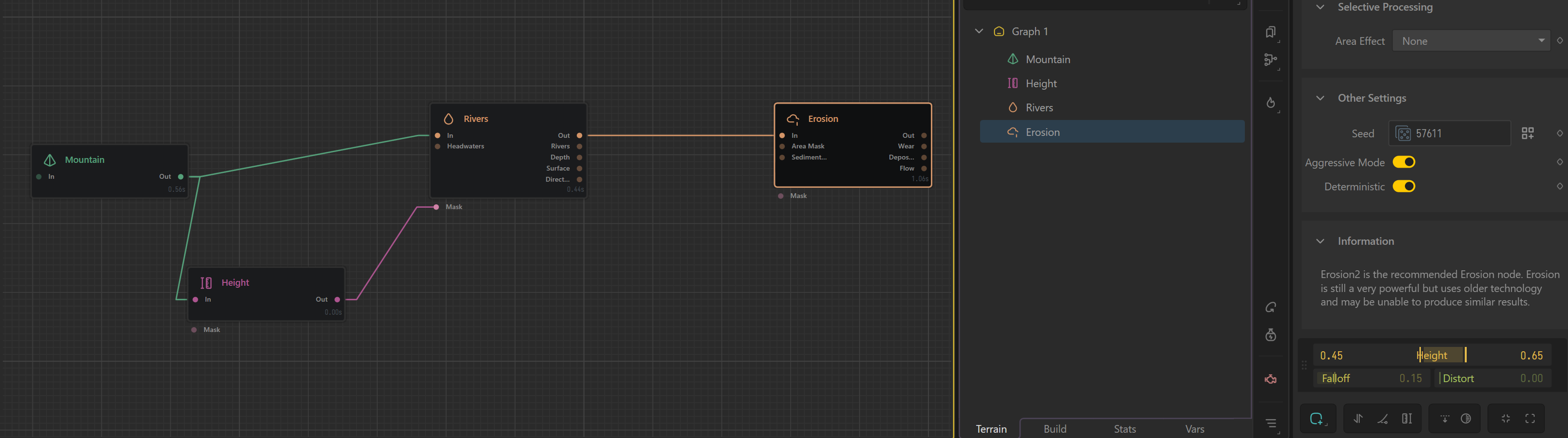

I would try using a mask by height feature on the other forms of erosion and a height node as a mask for rivers.
