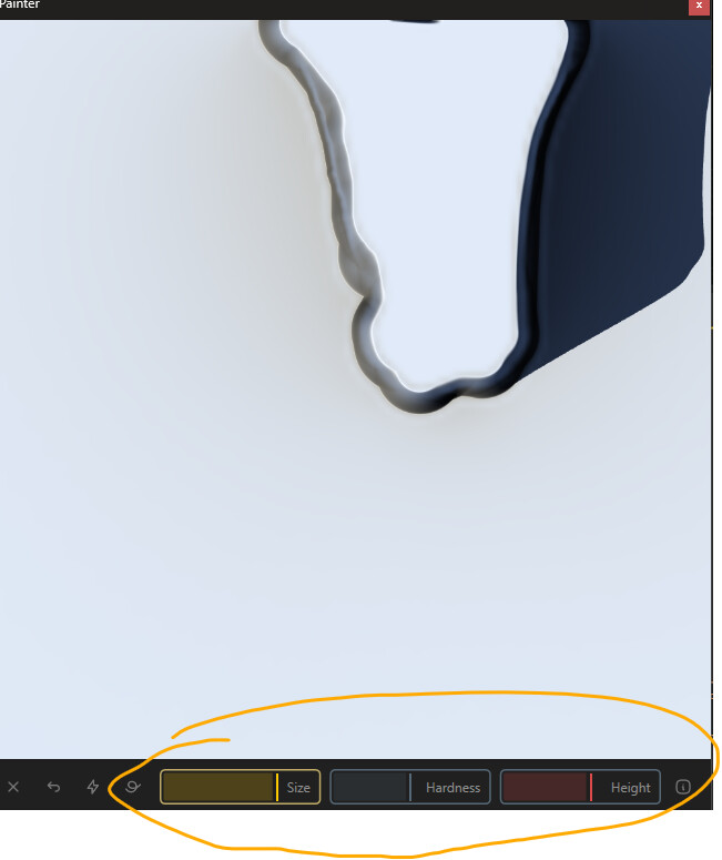

Hi,
For draw/painter, can I input exact number? Because currently it seems to only allow sliders so I have to guess-estimate roughly height I’m painting at.
If there’s no input, I hope it gets implemented in gaea 3 and also a pick color option.
Thank you
