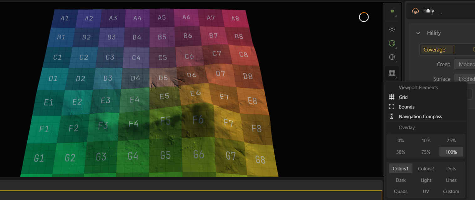

“Overlay” might just be what you are looking for. There are some preset images already loaded and you can even load your own. There is also the grid to look for when looking at scale. Each smaller section on grid = (Width/40)m

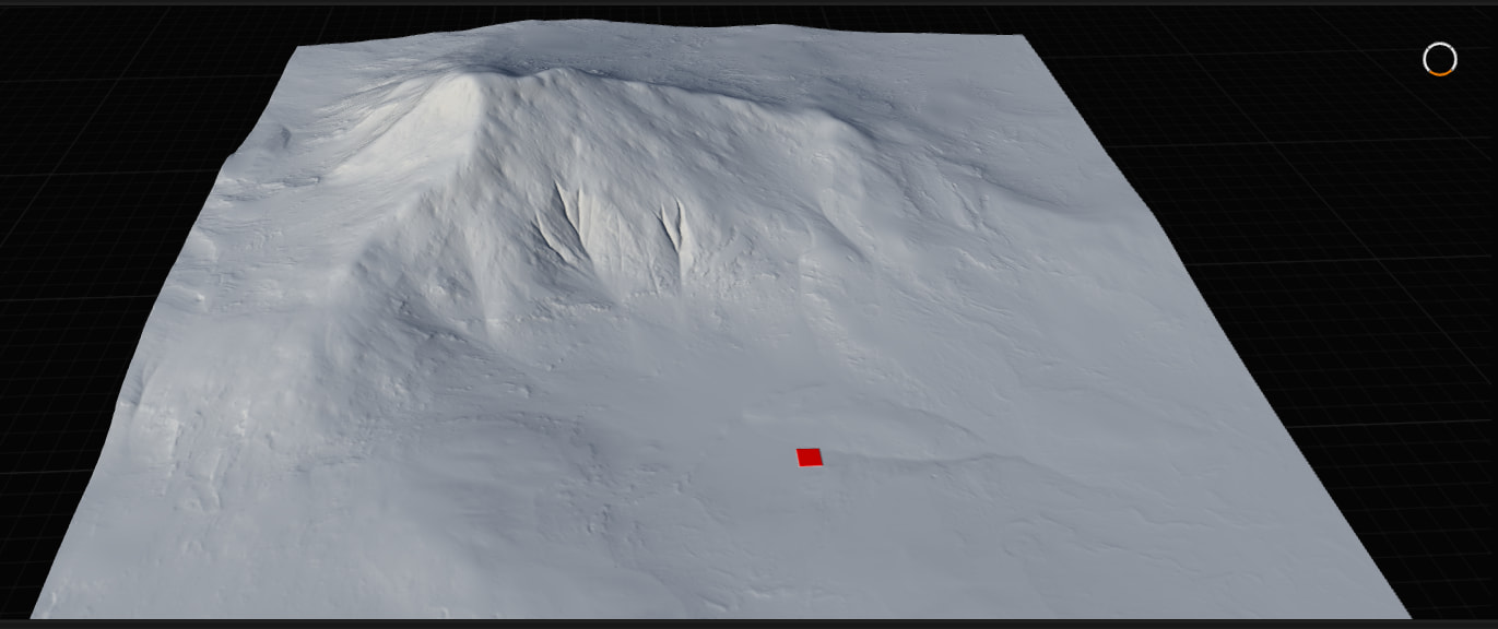

To give you some perspecitive the video i have here is a human scale or 160cm tall and 1m wide in the default terrain scale as you can imagine, you just cant see it.

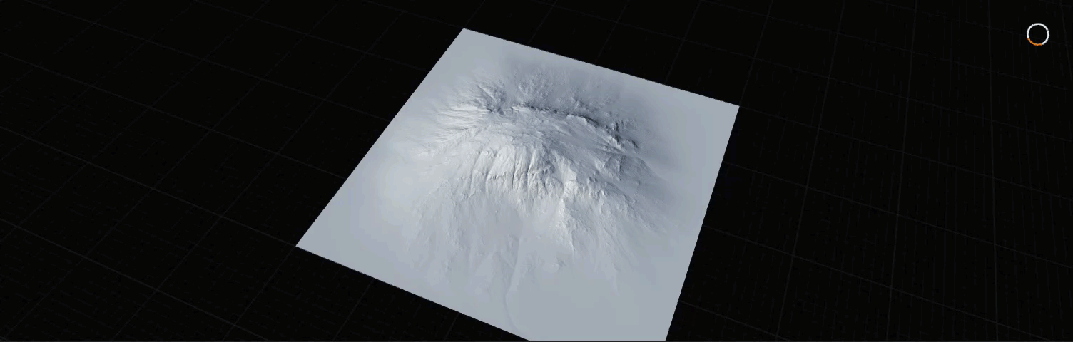

If you scale the terrain def down to 100x100m you can also add a 2x2m cube and the same 1.6m height which could represent a hill fairly well.

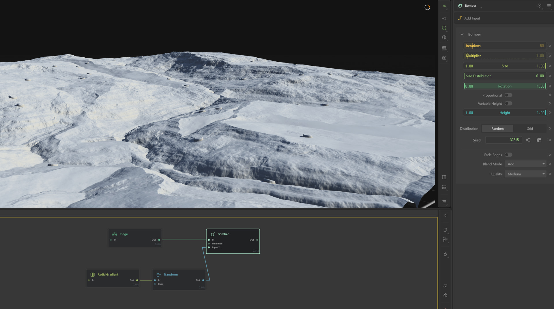

I still do this to visualize scale better, Custom scaled shape that you can bomb on top of the terrain to get a sense of scale. This here is a 30m wide and 10m tall cylinder. Human scale would be too small, but you can import familiar shapes or use basic shapes at different scales 10m, 50m, 100m for visualization. Height is easy as you can autolevel + clamp to input precise values but for width, I first used overlay + grid to roughly get the scale I want.

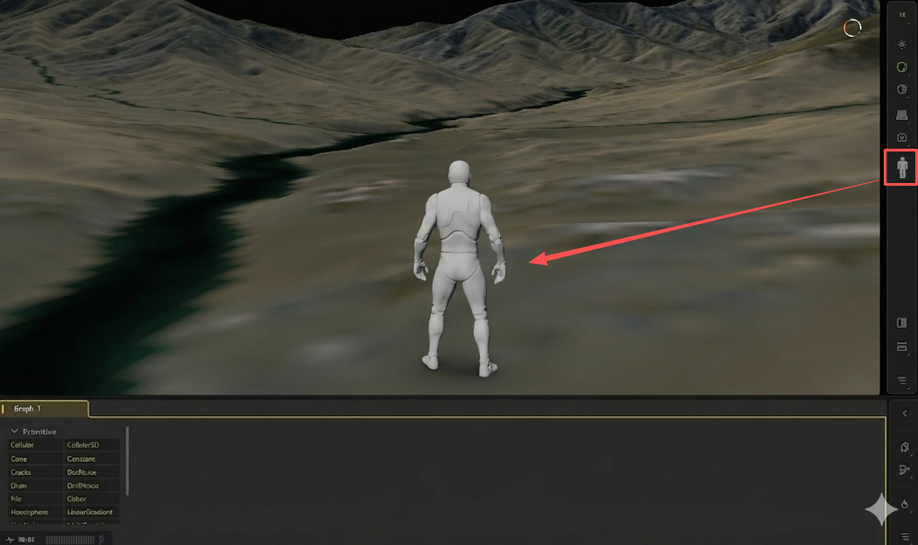

I completely agree. I also hope to have a character that can test the terrain scale. And it should be possible to move directly on the terrain. This is a simple drawing I made. Basically, the user clicks the little person icon in the right toolbar, and an in-game third-person character is automatically generated at a certain position on the terrain, and the user can control his movement. Hahaha
