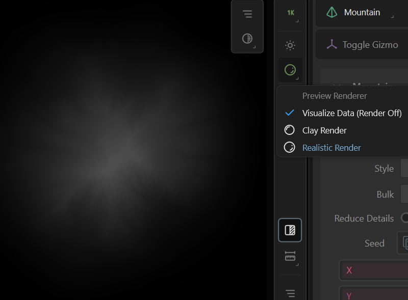

2d view showing the 2d output
Hi, if I remember well the 2d view in Gaea 1 showed the greyscale image. However in Gaea 2 it shows the shaded model, how can I change this to the greyscale displacement map?
Do you mean the data render? Or do you want the 2D render specifically like this, separate from the main viewport?
Keyboard shortcut T or as shown above, this is only visual mind, check DataView- Statistics tab to see what type the node actually is.
Thanks! yes the Visualize Data , or t, is what i mean. But it also changes the view in the 3d viewport. Is it possible to view only the data render in the 2d view and the model with lighting in the 3d viewport at the same time?
Ah I see now, unfortunately not.
I believe both viewports are the same scene with multi cameras, no independent shader views.
