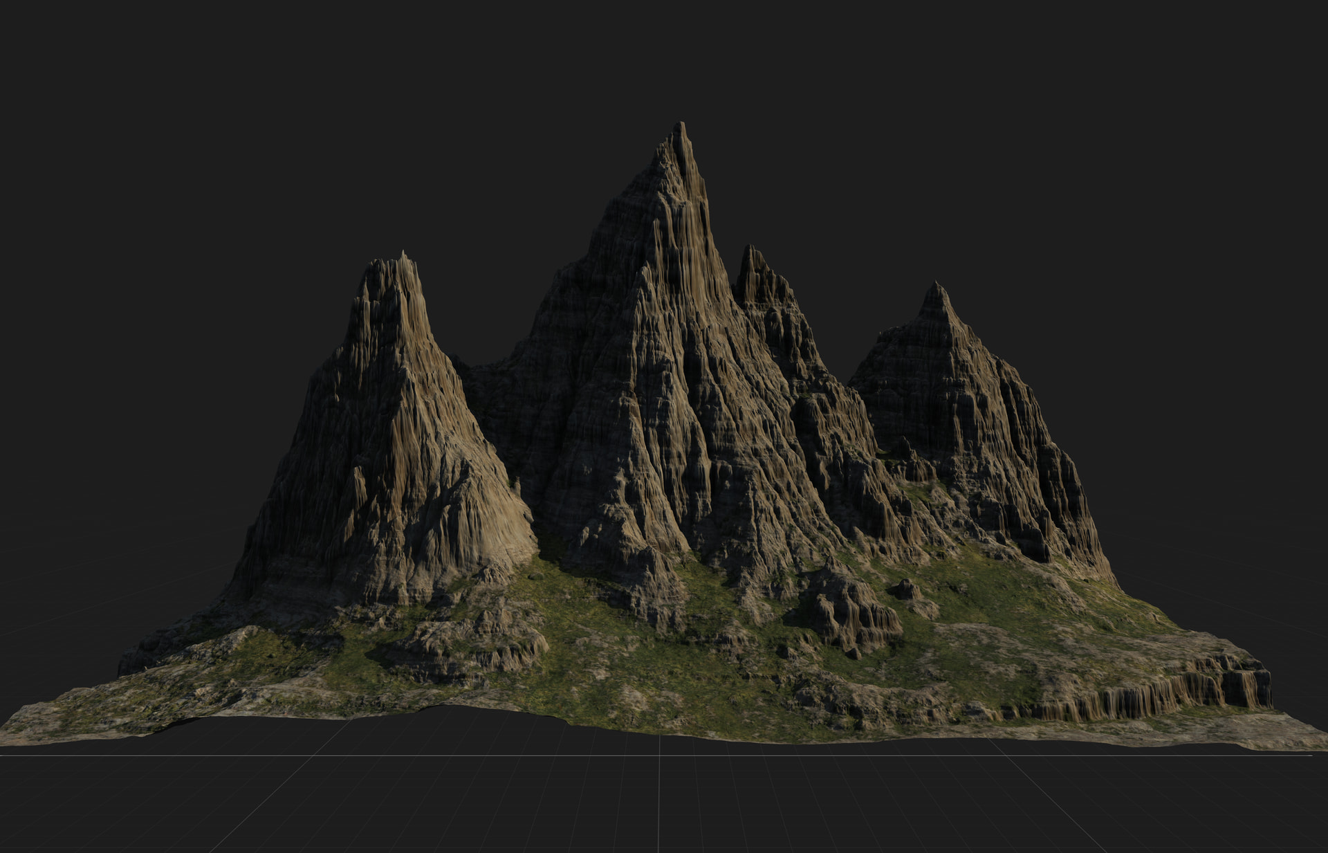

Hello guys, I’m working on a large scale environment for my personal project and this is one of the terrains in that, this is my first time using Gaea, i want a fresh set of eyes to look at this, thankyou.
I’m fond of how detailed and well-coloured the grass looks! The colours overall feel very natural, good job.
As for the cliffs, I think they could look a bit more interesting with more sedimentation around the base, and also if the terraces were tilted a bit (there’s an easy option for tilt in /FractalTerraces node) =)
Thank you for your feedback, I’ll try that.
Nice start, are you looking to show the rest of the spots as well?
I agree about the sediments even if its subtle. Do you use a mask for the sandstone node?
Thanks,yead, i did use sand stone node with a mask, that coupled with some erosions with shape set to lower number.
