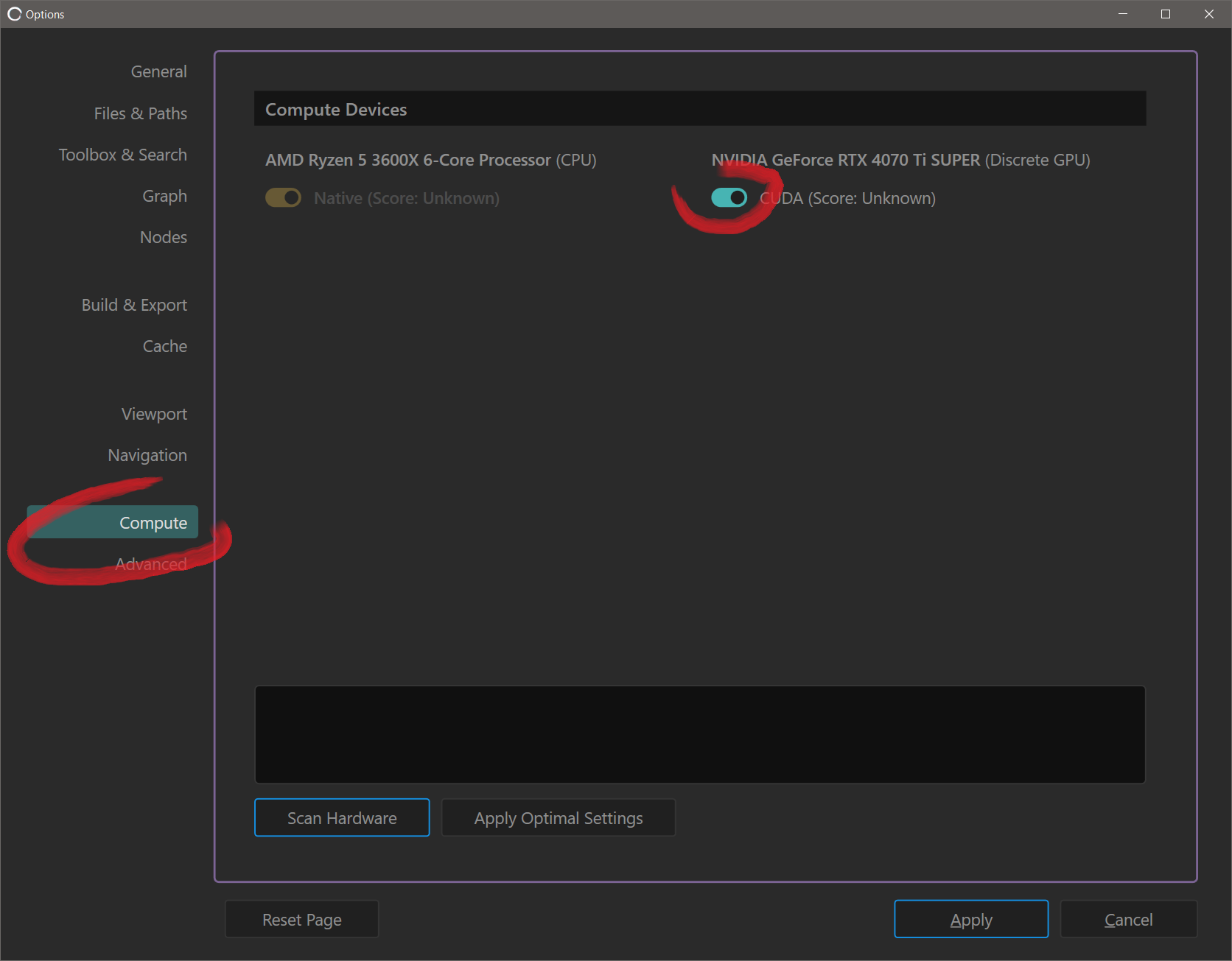

@ArtEyes G3 doesn’t take any more resources than G2 to me, and there shouldn’t be vast difference. If it takes you ten times longer for some of the same nodes that you already know from G2, please go to Tool - Options - Compute and make sure that your GPU is enabled.
Without GPU acceleration some nodes that normally take a second can take 20-30 seconds to get constructed, specifically orange nodes from Erosion category. Maybe this will reduce your waiting time significantly!
Thank you. That was what I needed. Gaea is performing way faster now!
