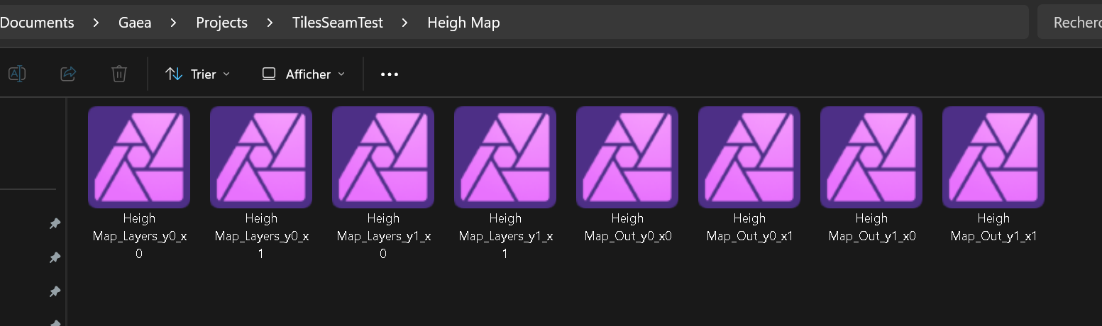

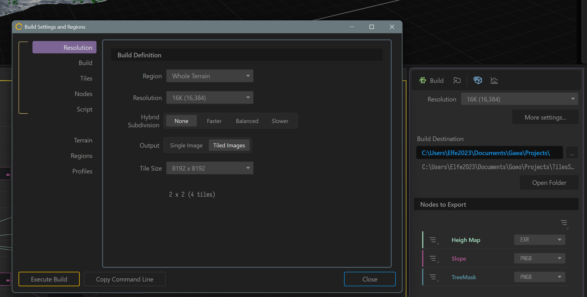

A four 8K tiles with no hybrid subdivision,slope, tree mask and height map marked fro export:
In the build folder, I find four slope maps, four tree mask maps and eight 8k height maps ( 4 “Map_layers” and 4 "Map_out) all different ?!?

So in your Heigh Map named node it has the output ports
it’ll build 4 tiles for each.
That’s confirmed on your screenshot.

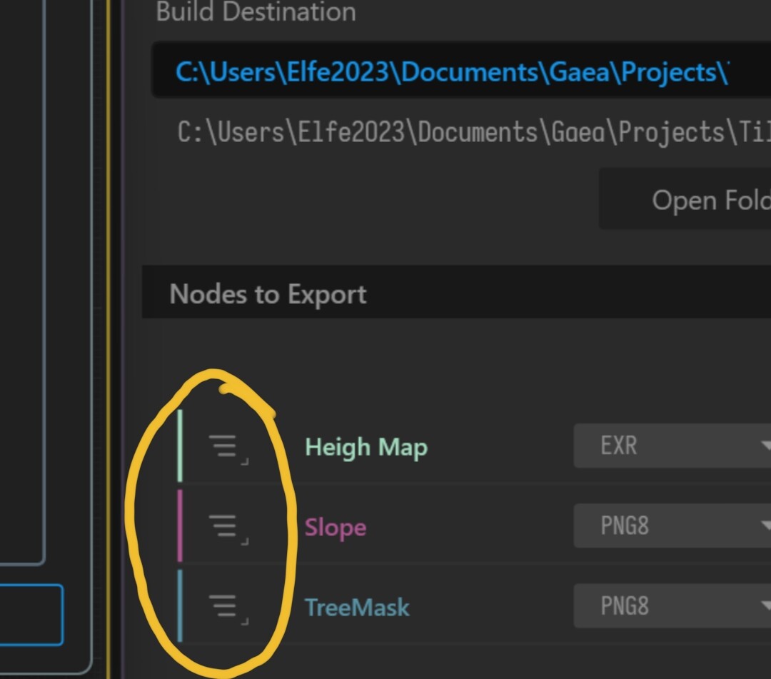

You can configure what output ports you want to build and export in the 'lil configure icon left of each node name there.
[!TIP]
You can quickly mark just the main out by selectingPrimary Onlyon nodes with lots of output ports.
Hope that helps!
