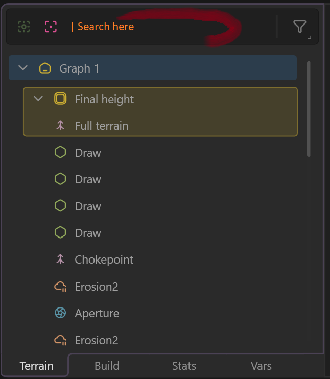

-Node search bar in Terrain tab in the data panel;

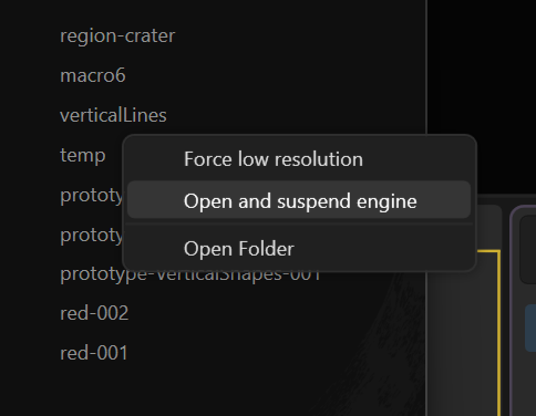

We do have a solution for this (to an extend) in the Recent Files list where you can right-click and choose Open and Suspend Engine or force it to switch to 512 x 512 preview. We’ll try to add it everywhere.

Add node search bar in the Terrain tab of the Data panel.
Yes! Searchable node numbers (e.g Combine 114).

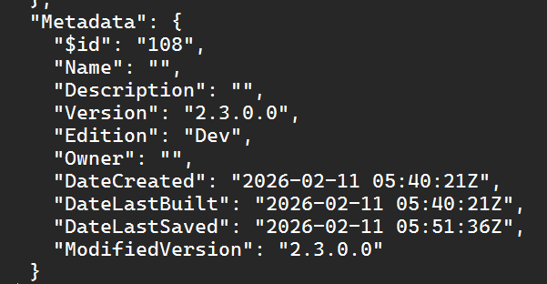

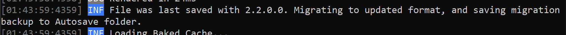

I suggest adding information to terrain files (and probably tfrag files if it’s feasible) like EXIF data about the version of Gaea they were created in and modified in last time (separately). Because whenever some breaking changes happen, it would be much easier to either track where it happened or to roll back to the version where it works as intended. I spent some time ago trying to figure which version I should’ve used for my projects after the Transform node change, recently there was a breaking change in 2.2.9.0 (I’ve sent a ticket) and my Tfrags exported from old projects also break hybrid subdivision in new versions (also sent a ticket). So I think it would be useful both for technical investigation and for users who’d know which previous versions to use while stuff is being repaired.
We already do that.
When a file is opened in a new version/build, we log the old version and save a pre-migration copy.
Oh, nice. Can we access this info on the user side somehow? I’m not familiar with data digging in Gaea currently. :)
Yeah the whole .terrain file is readable in a text editor.
For the badge @Kosvid
Not directly, except as @James_S said by opening in a text editor.
I’ll see if we can add it to the Windows Explorer tooltip and Properties dialog for .terrain files. But this may not happen anytime soon.

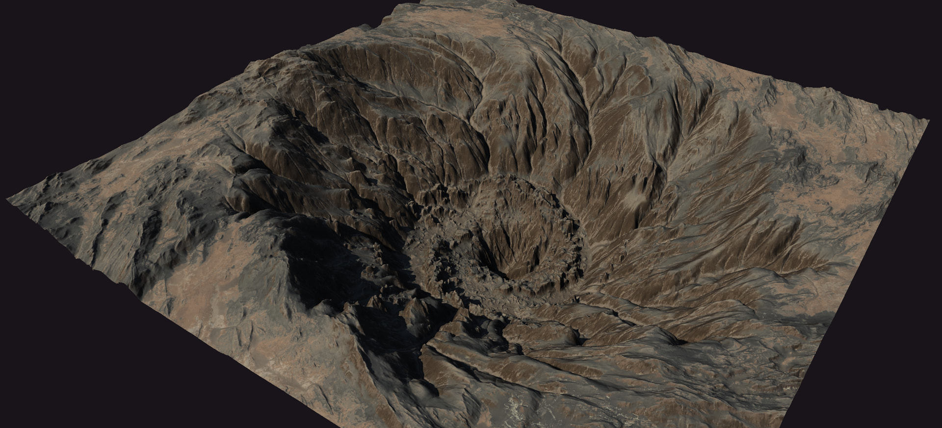

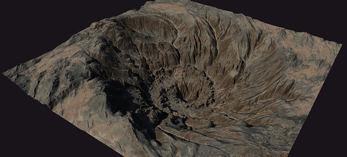

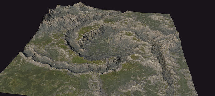

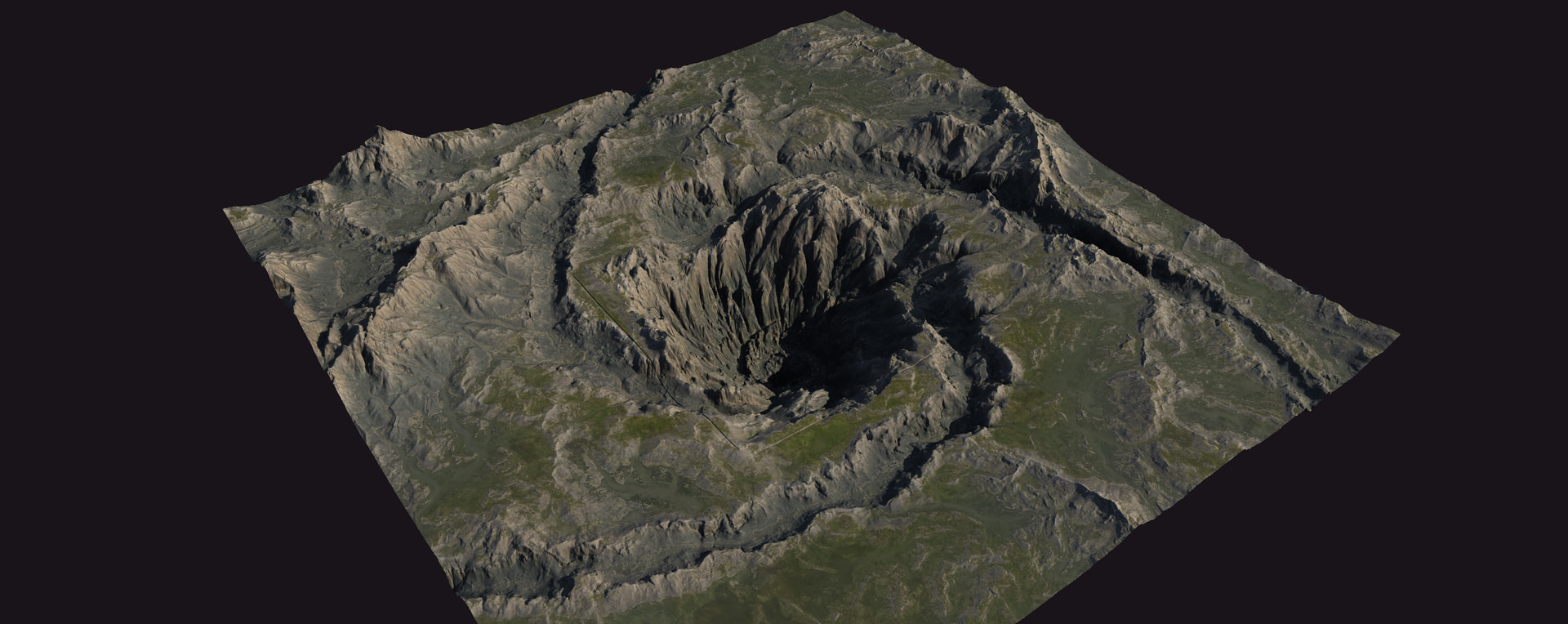

For example, here is an old unfinished project of mine. I created that somewhat stylised vortex and the area surrounding it by subtraction from the terrain and adjusting height.* The vortex has very prominent directionality to its shape, but the trenches are, well, just taken from the terrain. You can set up some directional erosion towards one direction, but there is no good way to maintain direction for complex paths (which rivers are, since they often swirl in all directions on small scale all the time).
*Additional consideration here would be to have an option for somewhat unifying the height of the trench across the spline, since if you just subtract a static shape from a bumpy terrain, your stream would be going up and down across the hills in a very unrealistic manner, so having an easy access to adjusting the terrain around to some set decline angle would be great. Some option of soft combine?..

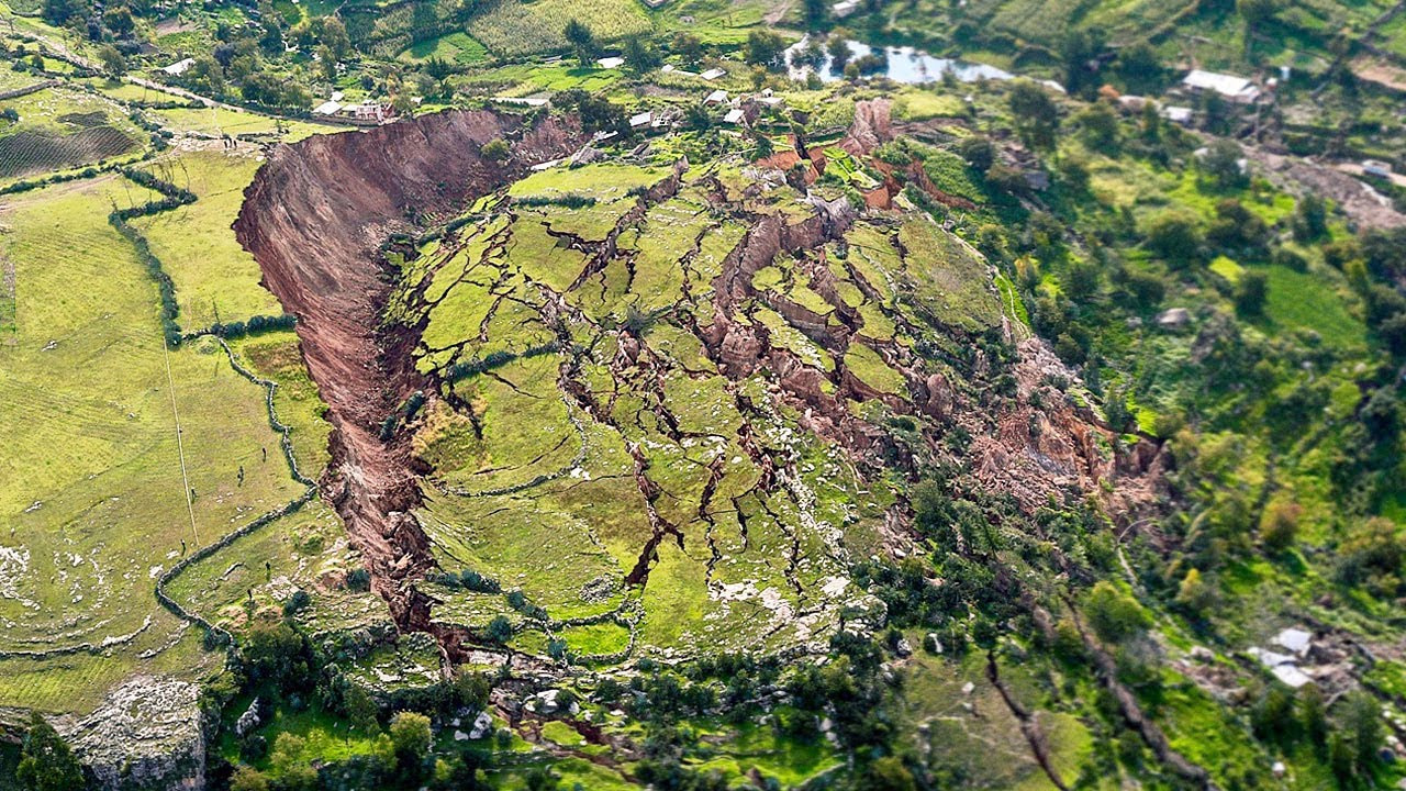

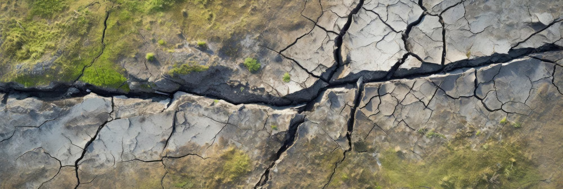

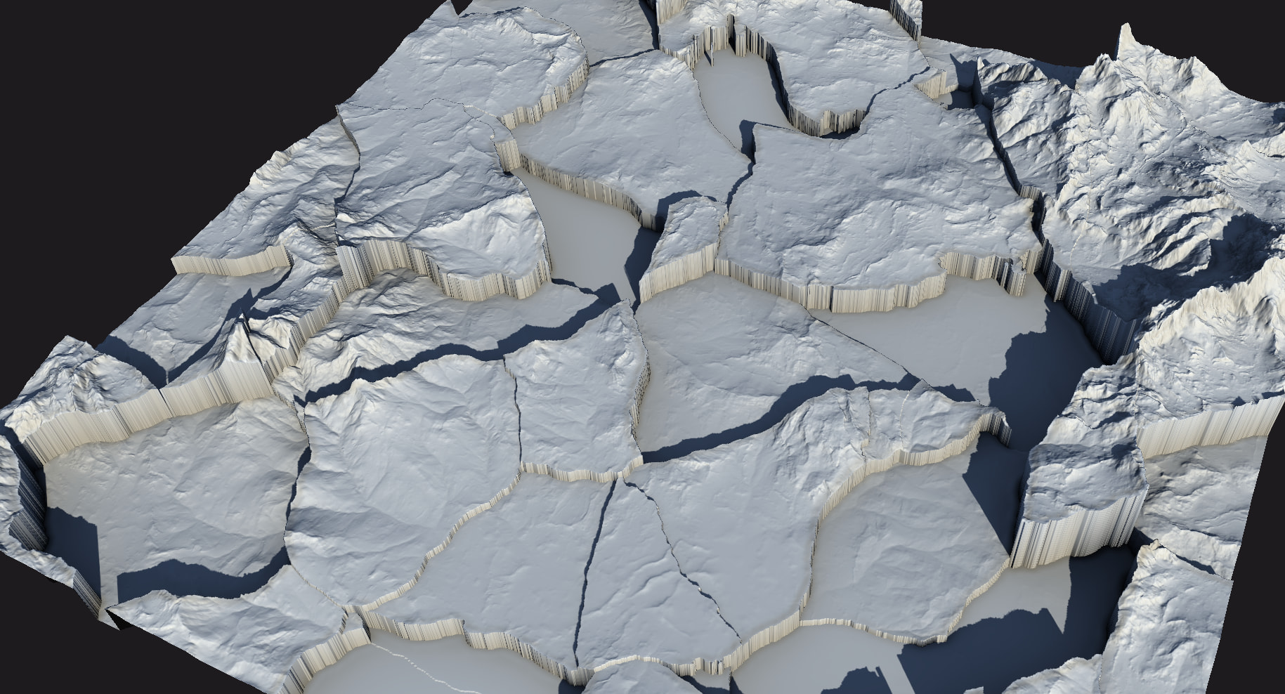

Oh, and a separate suggestion. “Split” erosion. Just cut-off, fall-apart kind of breakage of big chunks. Sadly, Gaea doesn’t have a good quick way to add rock split/fracture kind of destruction to terrain. You have to make complex setups for that with subtraction of ridges, or Crumble, or building your own basic structures out of simplest primitives, or other shenanigans. Glacier node is the closest to what I mean, but its use is limited for that.
I mean some quicker way to introduce faults, shattered breakage structures. They are hard to imitate at the moment, at least procedurally, without using textures or bringing in sculpted shapes. I think a node like that (either erosion or surface node) would really fit the program’s general direction of allowing achieving spectacular results with minimal sets of nodes. =)
P.S. I’ve tried creating similar patterns with chunks/islands of varying height after collapse, but even at the scale of 1 Voronoi creates islands too large to utilise them well for that. That comes back to the post above where I was talking about hard capped scaling. :melting_face: Please give us more freedom with scale and translation!

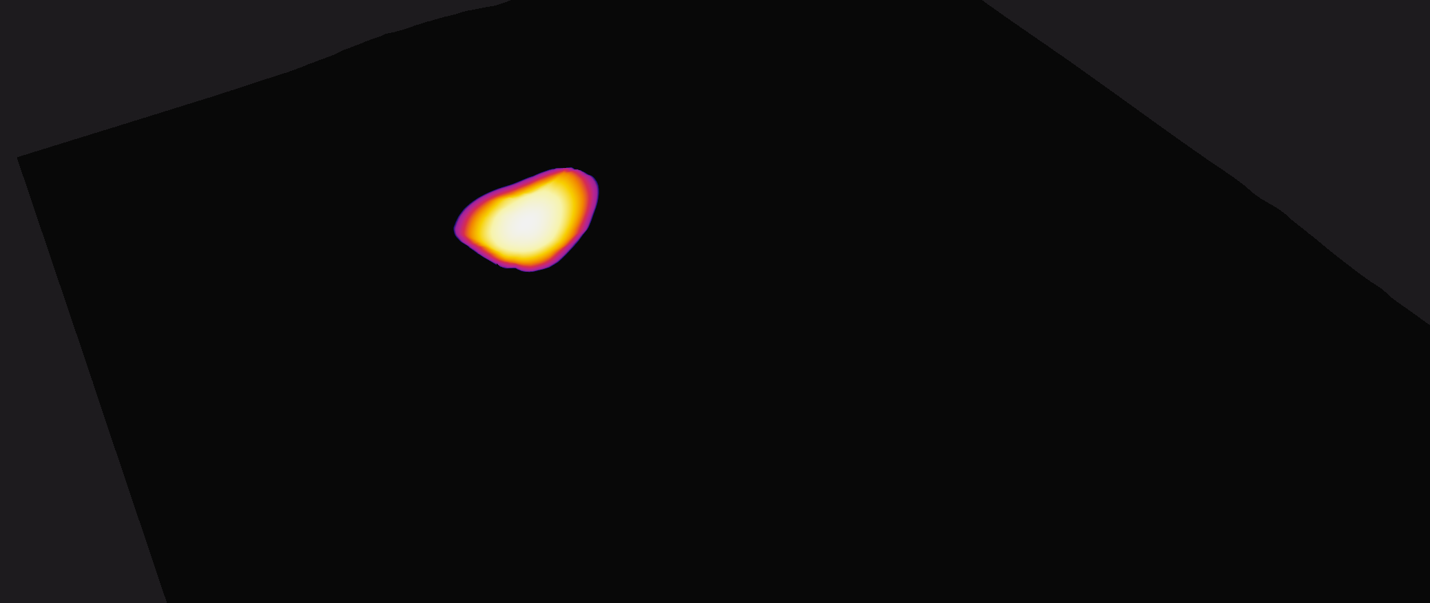

One more request: please add some sort of neutral highlight (probably occlusion-based or similar to Shade node) to the terrain base when working with masks. It’s very cool that they can have the terrain as underlay, but for many masks you can’t see the terrain at all to know where to put it precisely.
I’m using Heat gradient map, so simple grey would do. For the case when one is using the standard grey gradient map, maybe make that highlight tinted. Or, ideally, make it configurable in the visualisation panel. A slider for terrain occlusion highlight and a colour wheel for its tint.
