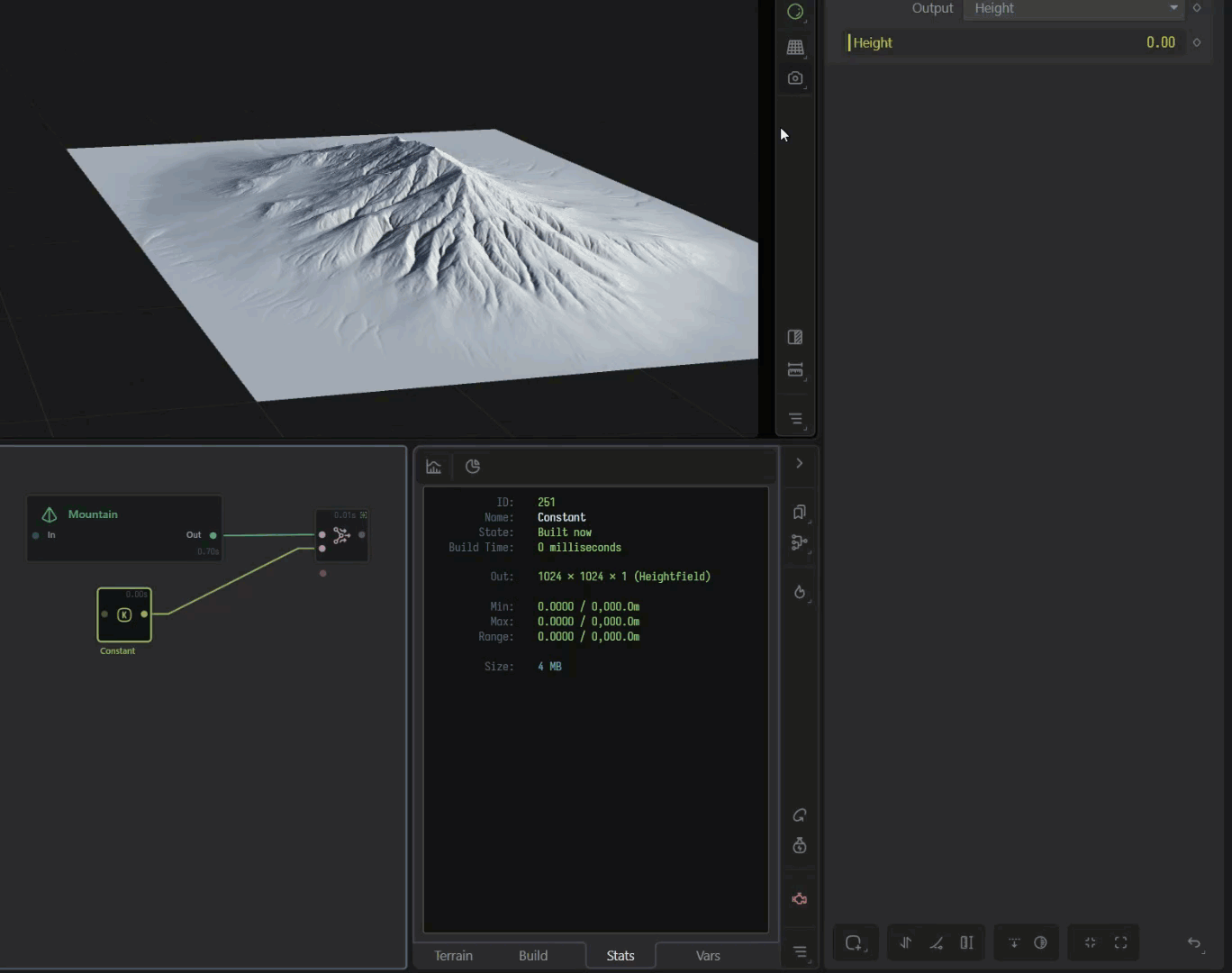

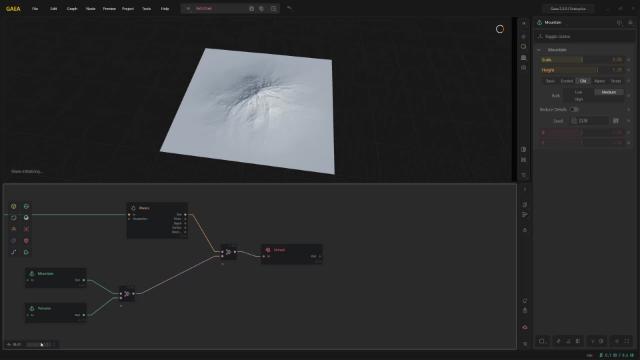

Thanks for that, that does help.
I return to you a video in kind.
Hopefully, this helps you refine your Gaea setup for export and simplify your pipeline.
Along with a short step by:
  • Try a single build at 8k
    • But be aware, you may need 64GB + of RAM
      • If you cannot or have low RAM, you may need to consider methods to optimise your builds, pre-bake some data, or use a multi-build pass.
  • Let Gaea2Unreal and Unreal Engine handle the tiling process of your terrain > landscape
  • Watch the stats of your final heightfield (/unreal node input)
    • along with the definition.json file this will determine what your _actual_ terrain min/max and range height is.
You can also additively /combine with a /constant node to move the height of the terrain (or part),
or remap its min and max height with a remap modifier. The latter option works really well for single-build compared to tile builds.
