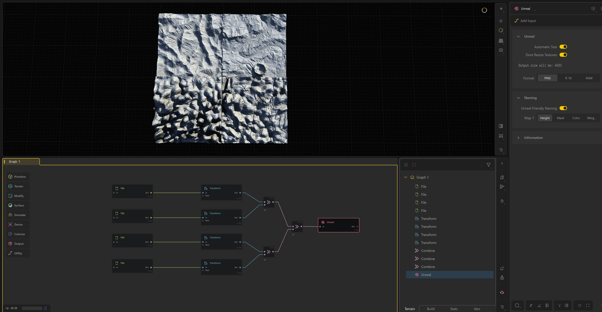

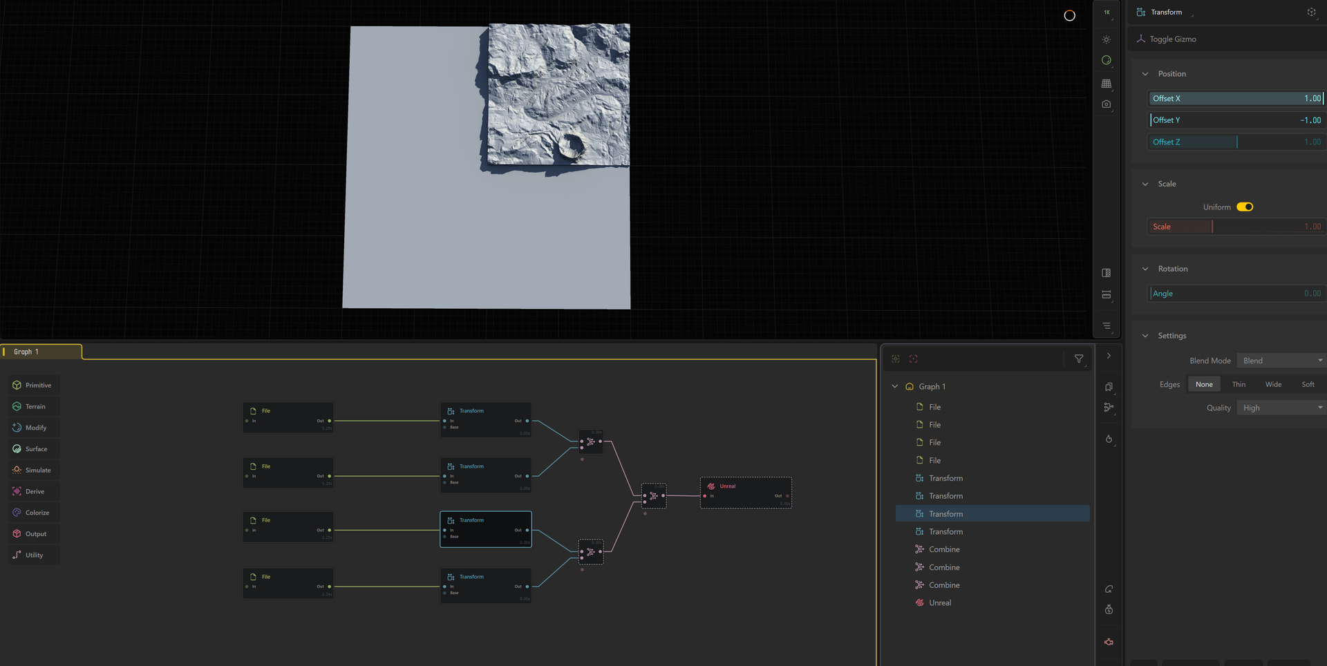

I imported the four heightmaps into a new Gaea project using File nodes, added Transform nodes, and tried to move each biome into its corresponding quadrant.
However, the Transform node only shifts the terrain within the existing canvas. When I increase the X/Y Offset (for example X = 1, Y = -1), the terrain is clipped instead of occupying only one quarter of the larger world.

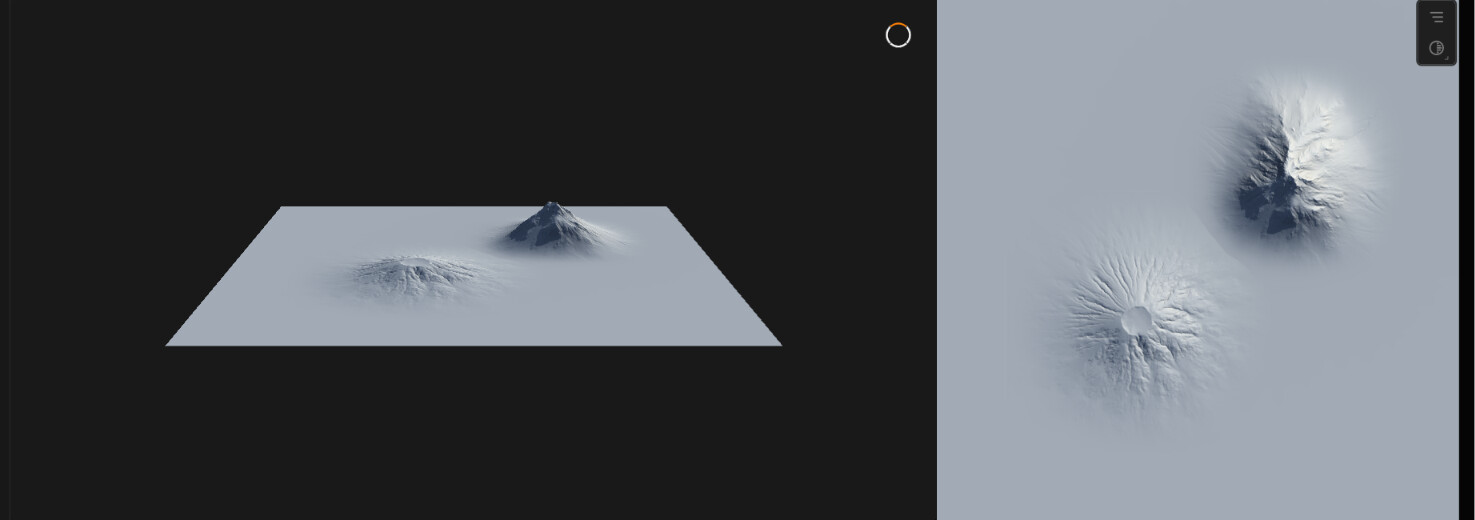

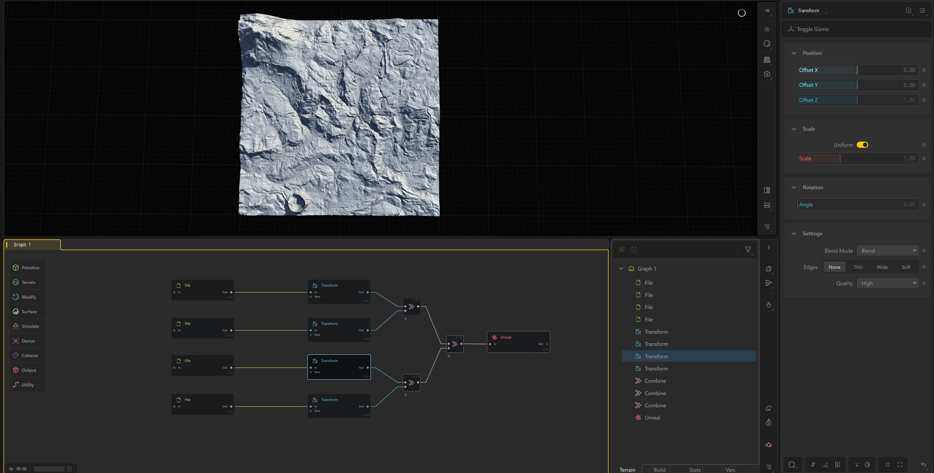

Below are screens from actual problem. Clipped by transform node terrain, unclipped version (you can see big mountain on the top left corner which is cut in one quarter position and full version with multiple clipped landscapes.

Generated in gaea 4k resolution 10x10 km PNG heightmap. In new gaea project uploaded via file node and wired to transform node. When changing X Y axis to move that heightmap into its place it cuts part of generated landscape. My discord is: holideus#3339 I can show you visually the problem there.
If you use a file node and keep “scale” to 1 in transform node settings, the imported file will use all the terrain surface => it will necessarily be clipped if you move it along X and/or Y.
Try with transform node scale parameter at 0.5

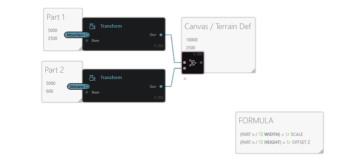

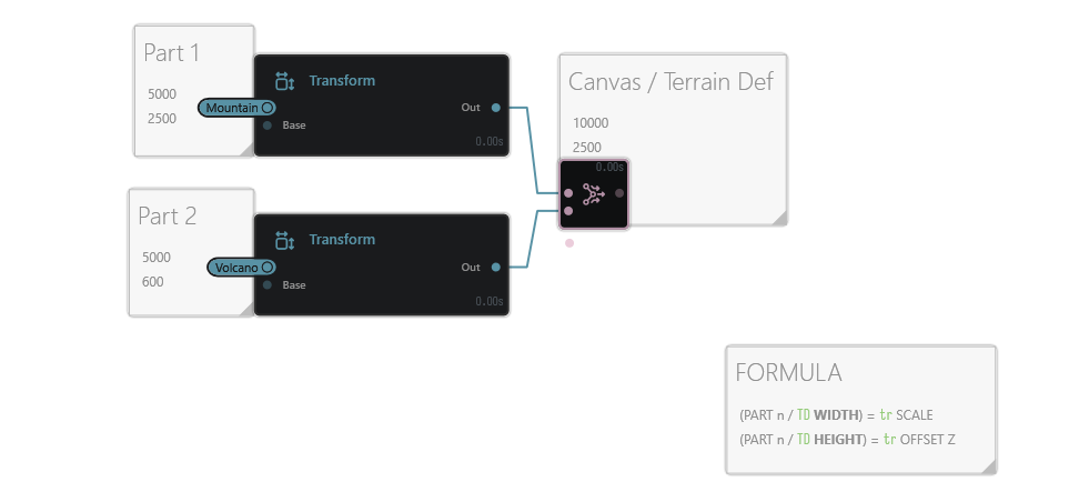

The cleanest method is to intentionally build your elements at the scale you want and then apply them to the correct final-scale project with all your blending of them together.
This is one goal of god mode and glue, but you can still build a static method this way as well, it’s the static part that is the long part when it comes to iterations and file handling for teams.
In this example there are two parts at different Terrain Definitions scaled correctly using /transform on a final larger Terrain Definitioned “canvas”.
