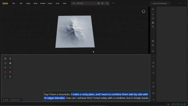

How do you combine two terrains together?
Say I have a mountain, I make a rocky plain, and I want to combine them side by side with th edges blended. How can i achieve this? I tried today with a combine, but it simply stacks them.

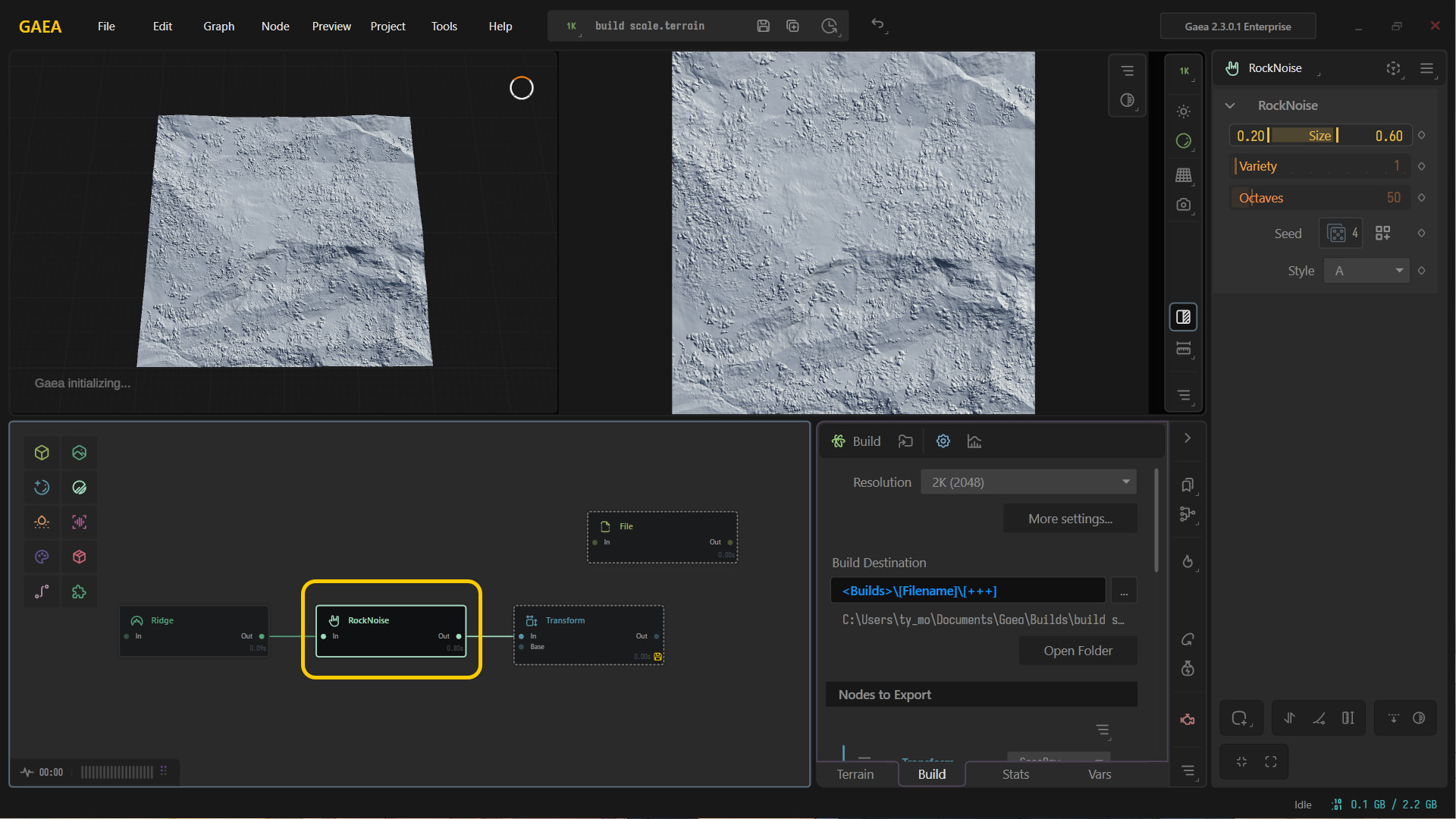

  1. Created two separate terrain/object shapes:
    • one representing the mountain
    • one representing the rocky plain
  2. Sent each one through a Transform node.
  3. Used the Transform nodes to:
    • scale each object down proportionally
    • move them freely side by side
    • control where each terrain sits in the final composition
  4. Before blending, I experimented using an Edge node to soften/lerp the borders.
    This helps avoid a sudden hard edge when the transformed terrains are placed next to each other, but I did end up using the edge function in the transform node instead.
  5. Then I combined them and tested different blend modes, such as:
    • Blend around 50%
    • Screen
    • Max
  6. Once the placement and blend felt close, I added a very light erosion pass at the end of the combine.
    That final erosion helped ā€œgelā€ the two shapes together so they felt more like one natural terrain instead of two separate pieces placed side by side.

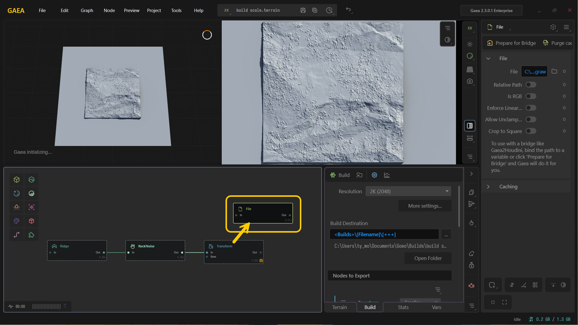

The basic gist is this:
I’m not changing the scale of the project, I’m changing the scale of the objects and increasing the resolution of the render to showcase the ā€œeffectā€ of this
Under the hood, what I’ve done is:
  • taken an object(s) at 100% scale and height and reduced them by 0.5
  • then increased the resolution to restore that 100% resolution and ā€˜in scale’
  • giving myself more workspace.
  • from a resolution PoV, each object went from 512 (512 /2)*2 = 512 and workspace 512 > 1k
[!error]
The video shows a mistake by setting the viewport resolution as 2k, but it should have been 1k. The theory is still the same regardless.
Blending
Towards the end, I started to play with the edge blending ideas, whether the /transform - edge mode was best or the /edge node itself, followed by a final light erosion pass to blend them after resting on a suitable blend mode.

Scaling Result After Build
As a final rough comparison
The 1k 100% scale vs the 2k 50% scale at 100% scale being identical.
