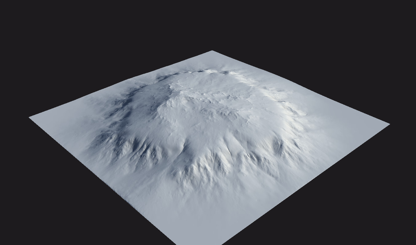

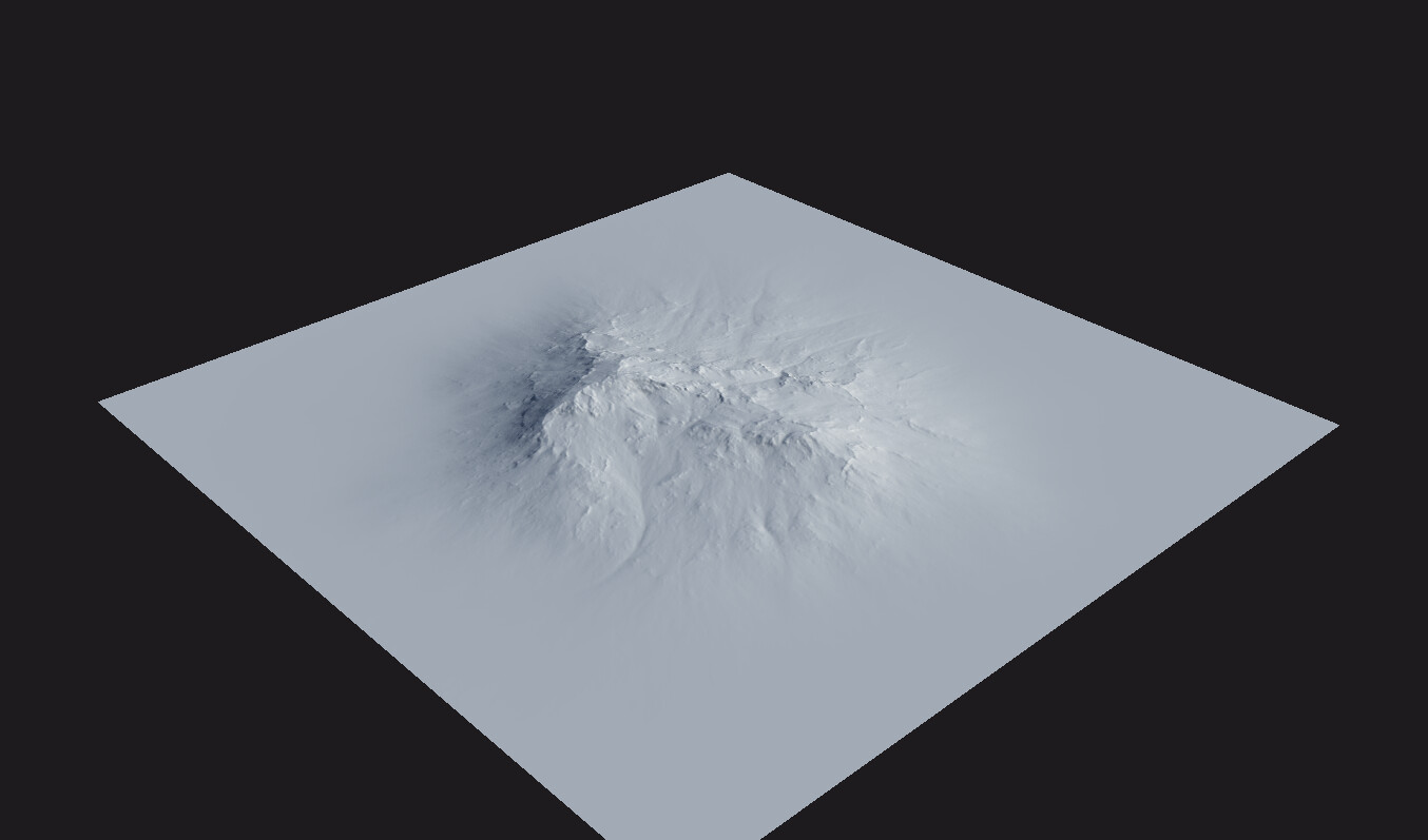

I have this heightmap I want to transform
I want to create a extension of the terrain so that I can make interact better with the coast but I cant seem to be able to manipulate the slope with a single curve node.

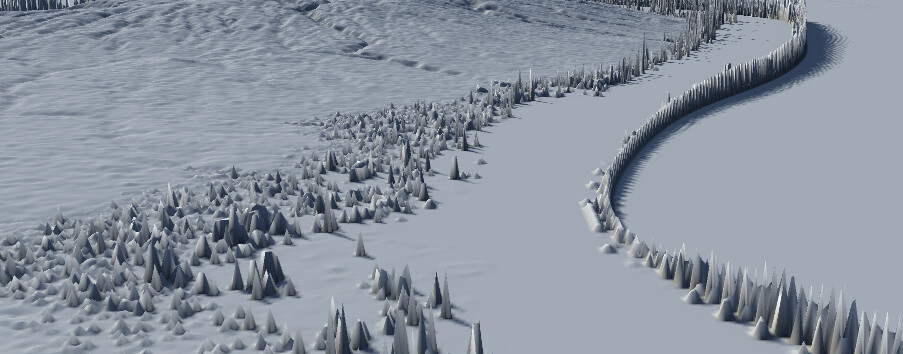

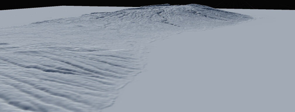

I think I am supposed to use the slope blur but it make a undesired… stuff?

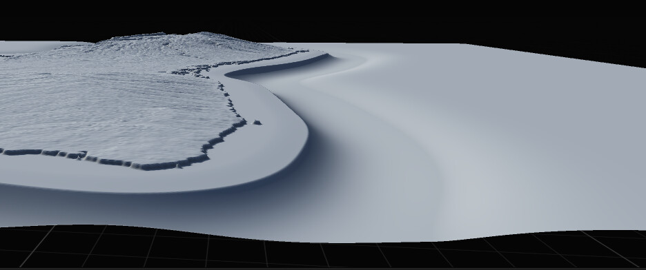

I would do something like this.
It might be mildly overcomplicated, but that’s my way, I guess. :D
It has good level of control, though. :)
Help 12 (Adding a shore).terrain (38.5 KB)

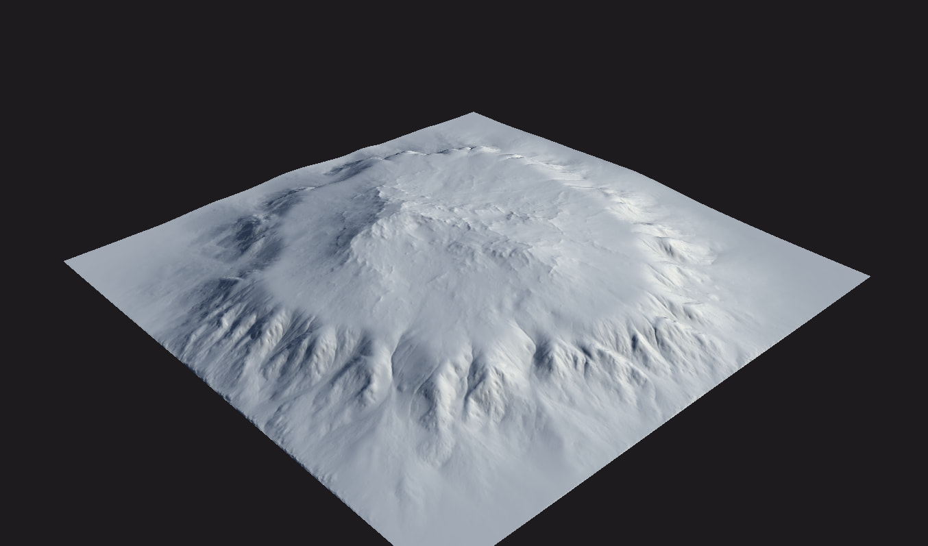

You’ve got a good base already in the second screenshot, though. You could just do an erosion and mask it by height to affect only the area below your “actual” terrain.
