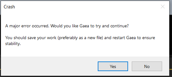

"Major Crash" generated when attempting to Save
Exactly as the title says. I open a clean new file, do Ctrl-S or manually click the save icon and Gaea opens up the major crash dialogue box.
I cannot say since when this has been happening, nor is running Gaea in Safe Mode, CPU Only, after cleanup fixing the issue.

I generated a Watson Log: 3D4-20260326
The error in the logs says “Win32Exception (15): The system cannot find the drive specified.”
Something pinned to the sidebar, or some drive seems to be causing problems. Please :sparkles: Gaea 2.3 Bleeding Edge 1.

Tried the Bleeding Edge build and I did not get a crash.
I did though get the first-time-boot sequence where it asked me to set my project paths, something I don’t remember being able to set again on current stable Gaea 2.
