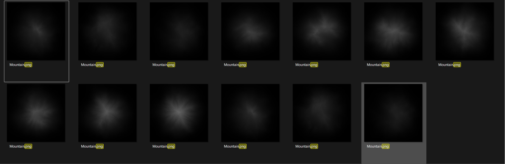

Hey @Dylan_Gunawan,
For mutations, you can use the method in the Gaea 2 docs, which is to add --Seed <int> to each batch command.
You can also add [Mutation] to the Build Destination so each mutation is saved to a separate path instead of overwriting the previous build. (By default, you will get numerical build folders rather than overwriting)
There is also a typical CLI workflow here, along with a CLI arguments list in case you need more information.
For a quick GUI method that gives you the base setup:
Project > Execute Batch Build... > Add Mutations > Start Batch Build
You can save the batch as a .bat file and expand it for a pure CLI workflow, for example, by adding other supported arguments or using a batch loop to generate more mutation runs, depending on how familiar you are with the CLI.
Hope that helps
