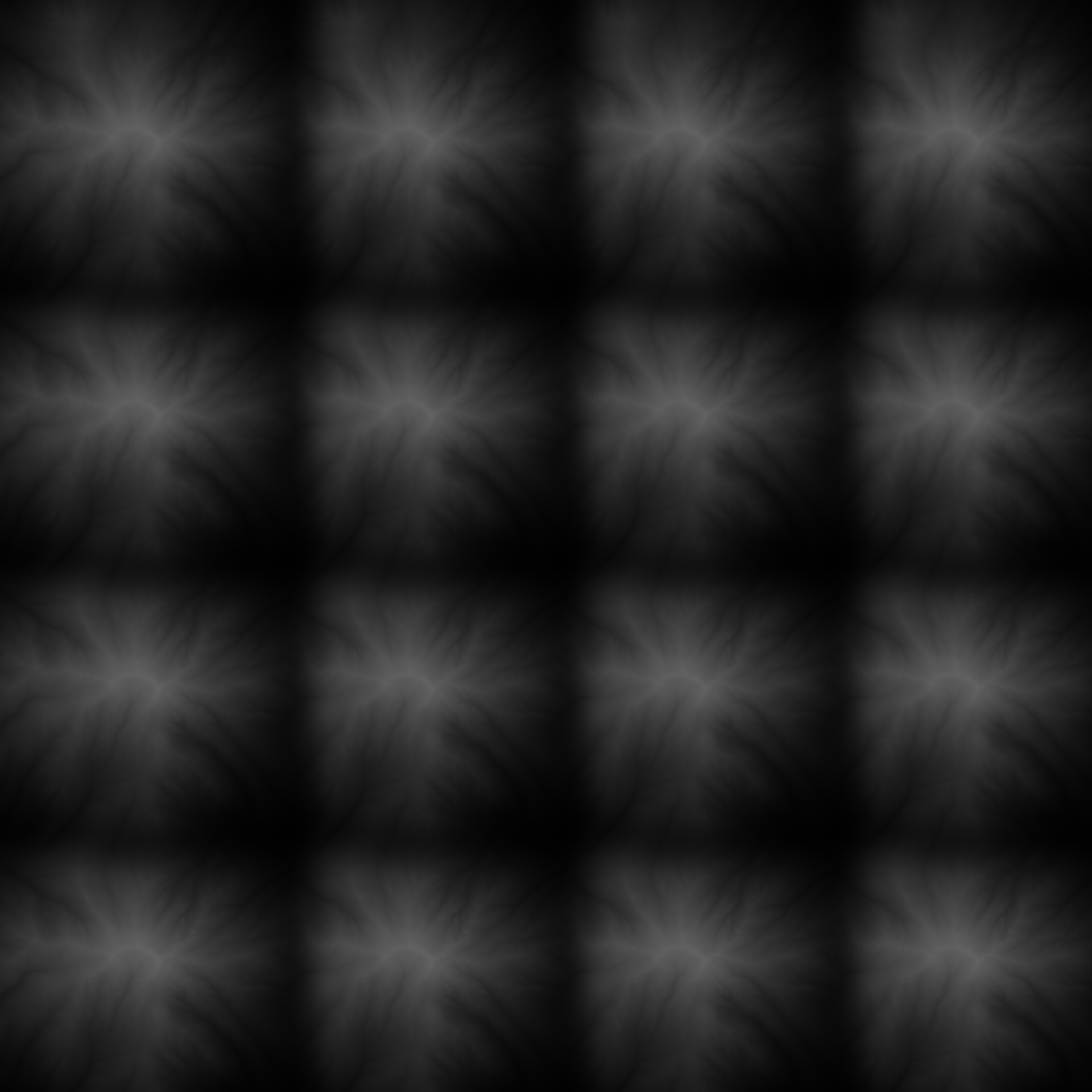

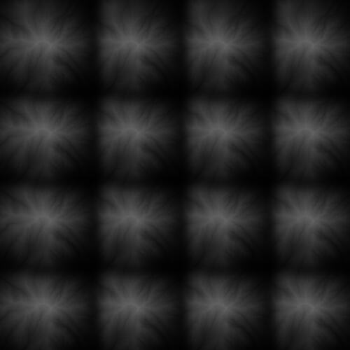

I downloaded the HybridBuild.terrain tutorial file and can’t seem to get the hybrid build to work at all. Without modifying anything, I changed the build resolution to 8k with a bake resolution of 2k and 16 subdivisions. I then went to the sidebar and clicked “baked all required nodes” and ran the build. As you can see below the resulting image is just a pattern with one tile for each subdivision. I’m just trying to get a grasp of what’s happening here and why this isn’t working for me.

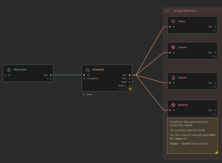

Just for reference this is the graph:
This is the result I get directly from the output of the Erosion2 node (the “Export” node’s output looks exactly the same too):

Absolutely insane outputs :scream:.
If you’re on the latest build it could be hardware environment issues, which leans more towards support ticket needed to be sent.
In the meantime you can try resetting Gaea from either diagnostics or options.
I will check the files again in 2.3 as well and update if needed just to be sure.
Out of curiosity are you on AMD or NVIDIA?
ALSO, have you tried to manually recreate this project to ensure a cleaner comparison?
It seems to work now after I forced Gaea to use the dedicated GPU on my computer. I have an AMD CPU and an NVIDIA GPU, which might have been the problem.
Great news! Well done for figuring it out and also this is good to know too.
