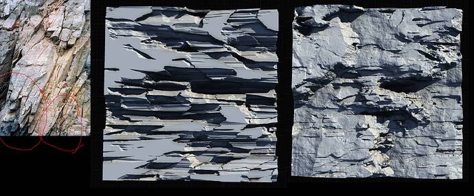

Hello! I was trying to make a sharp cliff wall with sharp bites:
i’ve messing around with voronoi primitives but I can’t find a straightforward method for representing those types of bites.
What do you think?
There’s probably no straightforward method for that advanced type of texturing. I sometimes use a stretched voronoi C or N slightly warped to influence a Warp node. Chipping the main shape with a Stratified or/and Sandstoned version of the terrain before warping can be nice.

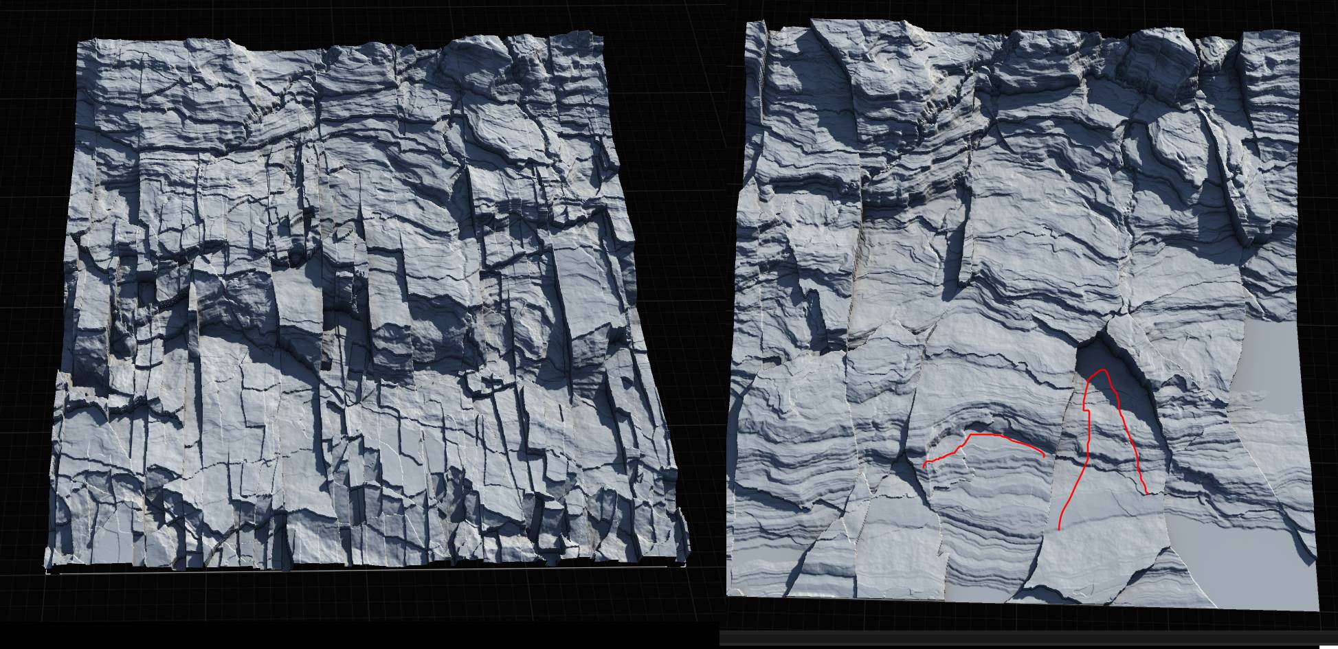

I’m trying to substract the first image to the second using a countour as a mask but the results are not what i expected, what should i do?
This already looks quite promising!
Unfortunately, I don’t understand what trouble you described there. Although it’s also been a while now. If you’ve got a fresher version since then, feel free to share, I’m curious what it looks like at this point. :)
