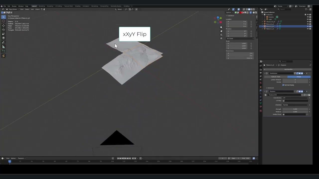

Tiles imported in Blender (xXyY/yYxX/UDIM Flip enabled or disabled)
Here is a video showing how tiles are imported in Blender 5.1.1 using “Tile suffix pattern” xXyY/yYxX/UDIM, “FLIP” enabled or disabled in each case.
  • OK using yYxX suffix pattern (FLIP ON or OFF)
  • NOK using xXyY (FLIP ON or OFF): Top Left / Bottom Right tiles correctly placed but you have to move Top Right tile to Bottom Left and Bottom Left tile to Top Right.
  • NOK using UDIM suffix pattern (FLIP ON or OFF): In the export folder, all .EXR look different as expected but when imported in to Blender, they all look like the first Top Left tile imported.
