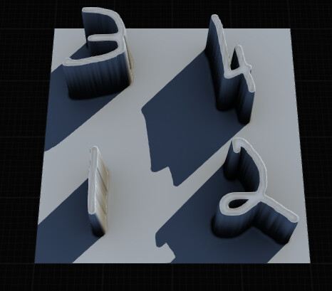

This is a small temporary workaround for cases where Gaea tiled UDIM exports appear to import in the wrong row order.
Some UDIMs logic is expected like this:
1011 1012
1001 1002
So 1001 should be the bottom-left tile.

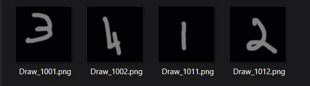

If your Gaea export appears to number from the top-left instead:
1001 1002
1011 1012
then the UDIM filenames need a vertical row flip.

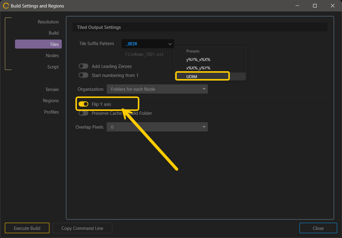

[!Warning]
There appears to be a bug where flip[ Y doesnt work / work with UDIMs
( please bug report if this effects you!)
This script does not change the image data. It only renames the UDIM numbers so Tiles are read in the expected order.
