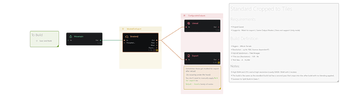

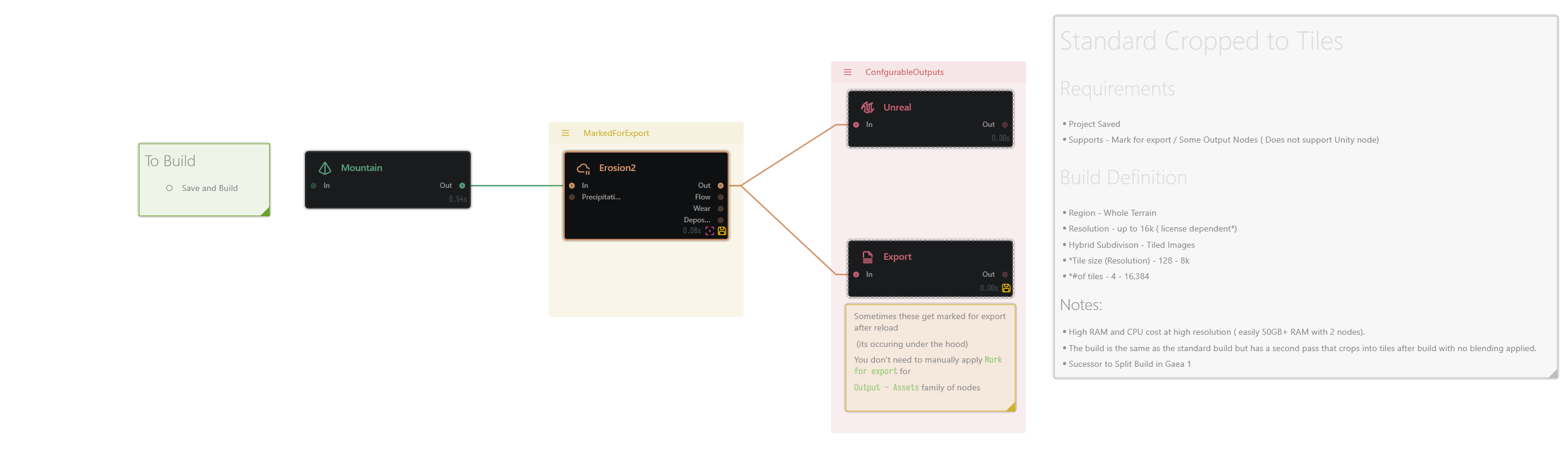

Standard Cropped to Tiles
Requirements
  • Project saved
  • Supports Mark for Export / some Output nodes (does not support the Unity node)
Build Definition
  • Region: Whole Terrain
  • Resolution: up to 16K (license dependent)
  • Subdivision: Tiled Images
  • Tile size (resolution): 128 to 8K
  • # of tiles: 4 to 16,384
[!Caution]
High RAM/CPU cost at high resolution > (easily 50GB+ RAM with ~2 nodes).
[!Note]
Same as the standard build, but adds > a second pass that crops into tiles > after the build.
No blending is applied.
[!Tip]
Successor to Split Build in Gaea 1.
StandardBuild_CroppedToTiles.terrain (6.1 KB)

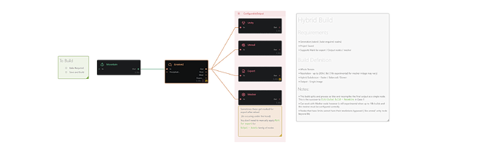

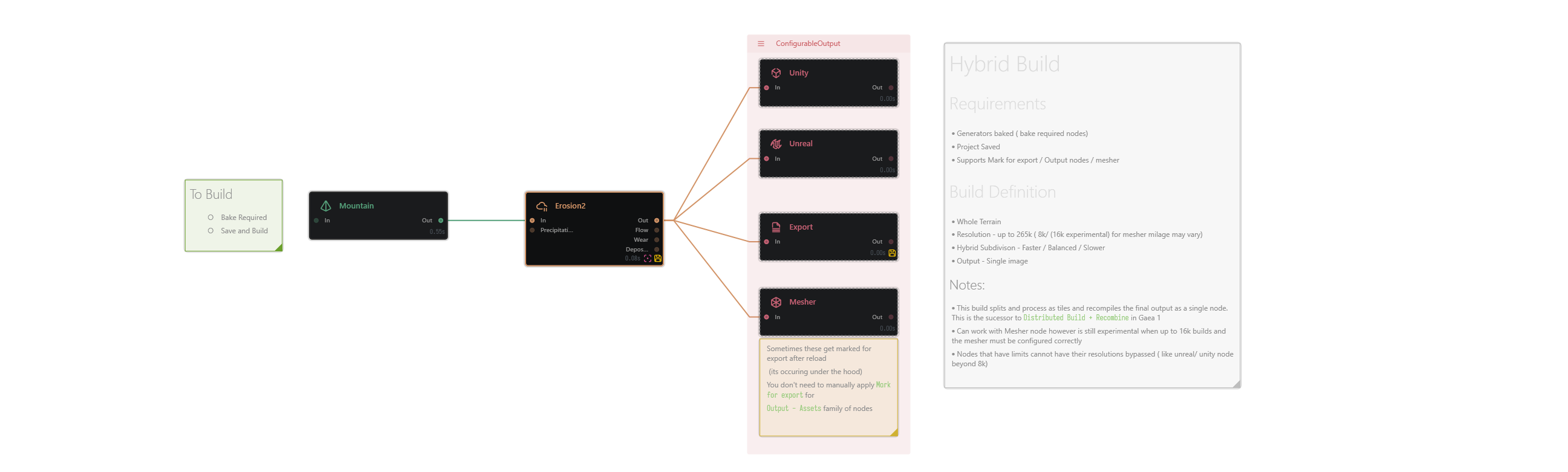

Hybrid Build
Requirements
⦁ Generators baked ( bake required nodes)
⦁ Project Saved
⦁ Supports Mark for export / Output nodes / mesher
Build Definition
⦁ Whole Terrain
⦁ Resolution - up to 265k ( 8k/ (16k experimental) for mesher milage may vary)
⦁ Hybrid Subdivison - Faster / Balanced / Slower
⦁ Output - Single image
[!Tip]
Hybrid Build processes the terrain > as tiles, then recombines to a single output node.
It replaces Distributed Build + Recombine from Gaea 1
[!Caution]
Works, but 16K builds are still experimental, configure Mesher carefully.
[!Important]
Nodes with hard caps can’t bypass their max resolution (e.g. Unreal/Unity export beyond 8K).
HybridBuild.terrain (7.3 KB)

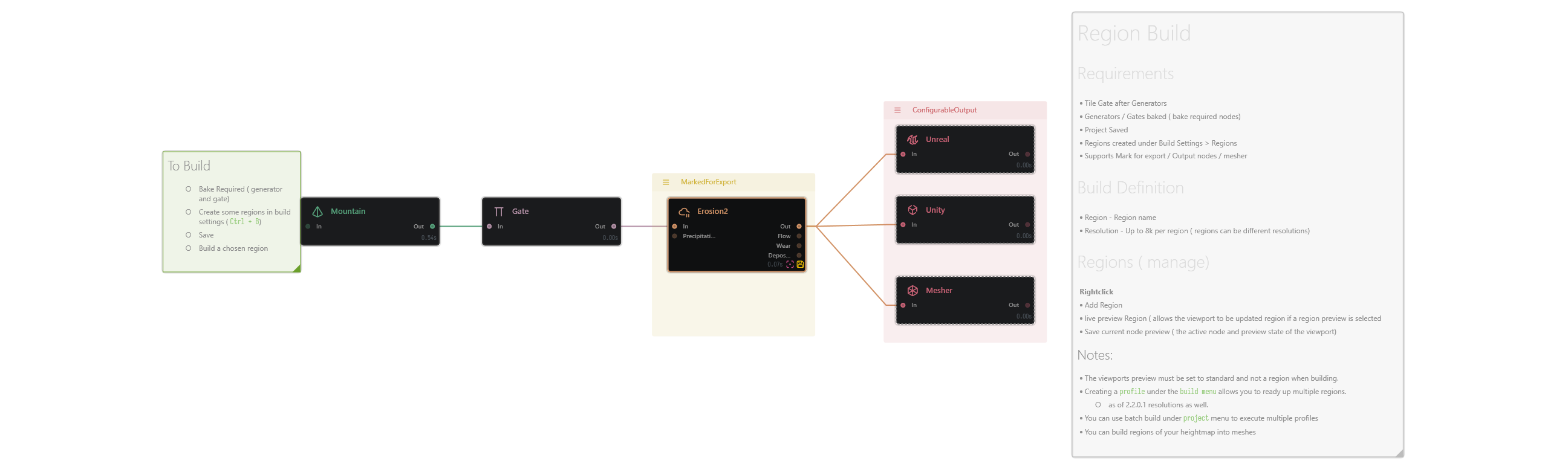

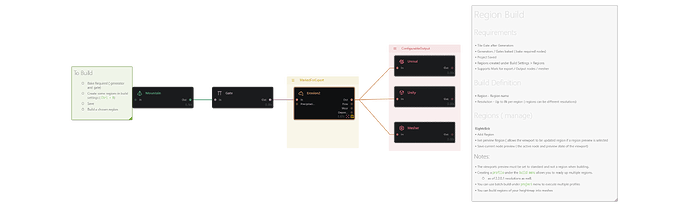

Region Build
Requirements
  • Tile /Gate after Generators / gates baked (bake required nodes)[1]
  • Generators / gates baked (bake required nodes)
  • Project saved
  • Regions created under Build Settings > Regions
  • Supports Mark for Export / Output nodes / Mesher
Build Definition
  • Region: Region name (not whole Terrain)
  • Resolution: up to 8K per region (regions can use different resolutions)
Regions
(Manage via right-click)
  • Add Region
  • Live Preview Region (updates the viewport to the selected region preview)
  • Save Current Node Preview (saves the active node + viewport preview state)
[!Important]
When building, the viewport preview must be set to Standard, not a Region preview.
[!Tip]
Profiles: Creating a profile in the Build menu lets you prepare multiple regions and their resolutions as well.
[!Tip]
Batch runs: Use Project > Batch Build to execute multiple profiles.
[!Tip]
You can build region outputs of your heightmap into meshes.
RegionBuild.terrain (7.6 KB)
  1. Tip: Use Data View filters to identify nodes quickly. ↩︎

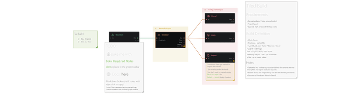

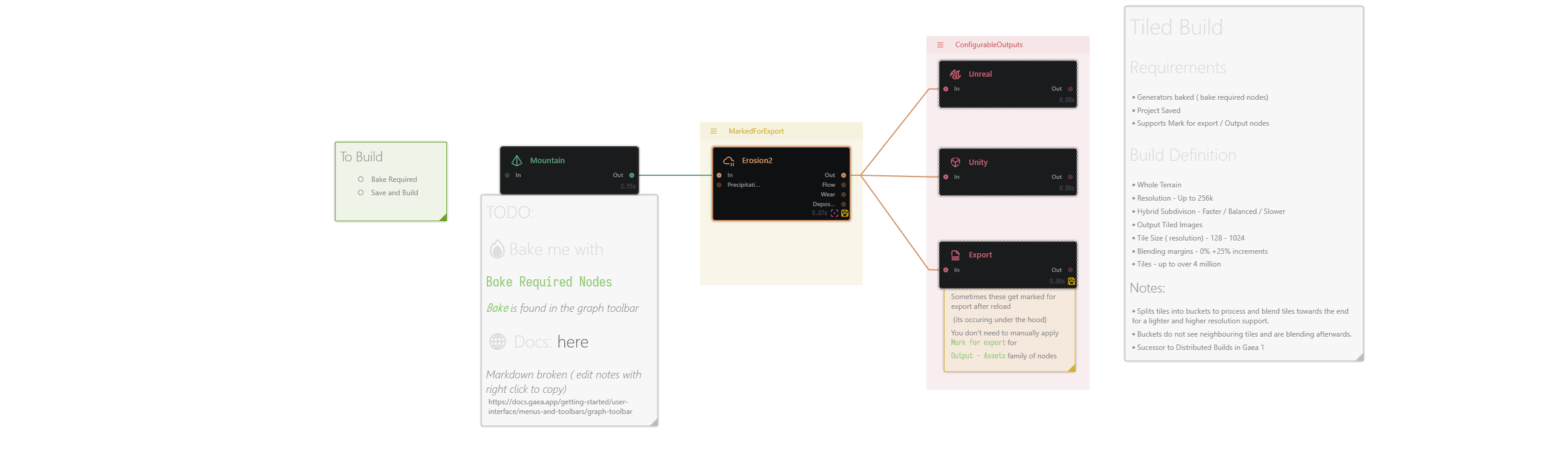

Tiled Build
Requirements
  • Project saved
  • Required Generator nodes baked
  • Graph prepared to be tile-friendly
Build Definition
  • Build mode: Tiled Build
  • Resolution: based on Tile Size × Tiles per Dimension
  • Tile size / per-tile resolution: set in the Build Manager
  • # of tiles: based on tiles per dimension
  • Output: Tiled images
  • Final terrain resolution: shown in the Build Manager readout
[!Caution]
Tiled Builds can become very heavy depending on tile size, number of tiles, and graph complexity.
Large builds may require significant RAM, CPU time, and disk space.
[!Note]
Tiled Build processes the terrain as separate tiles/buckets rather than one single full-resolution image.
This allows much larger terrains to be exported while keeping memory usage more manageable.
[!Important]
Non-tile-friendly sections of the graph should be baked.
[!Tip]
Best used for large worlds, game terrains, and workflows that need individual heightmap or texture tiles.
In Gaea 2, this is the main successor-style workflow for large tiled terrain output.
TiledBuild.terrain (7.3 KB)
