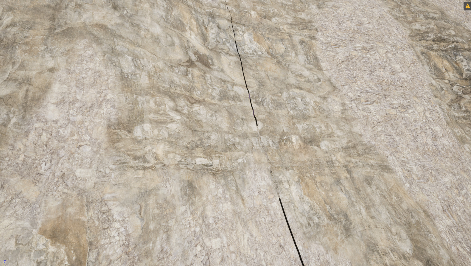

Landscape issue in UE world partition level
after importing I got seams like so, all over the level, is there a way to avoid it?
I import single 8k r16 landscape file from unreal node

thanks for answer,
it was single file build and the issue was on unreal side, apparently nanite skirt is a hard requirement with world partition levels
